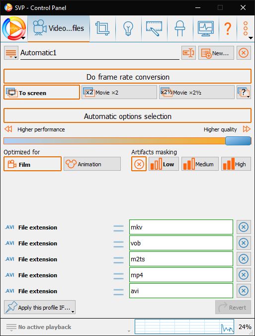

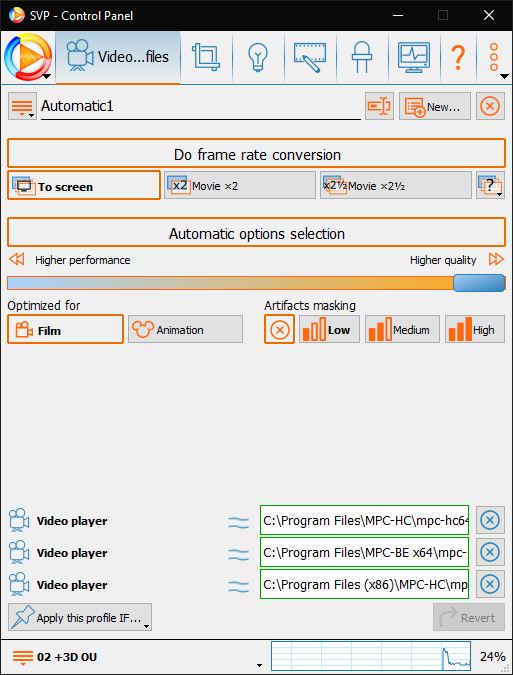

The profile I'm trying to apply is Automatic. Doesn't have that option. Made a copy of it and it did.
Tried to add player location and extension by playing a file in the player, and it would automatically add it (pictures below). However this did not add it as default profile.
On the bottom of the Conditions for Applying the Profile there is a mention of how to apply strings, which is different from how the software does it itself.
Got it to work by adding Frame With and Frame height >1.
01.JPG, 72.21 kb, 513 x 675

02JPG.JPG, 72.48 kb, 513 x 675

Re: How to set default profile
if you don't have any _meaningful_ condition for the profile you can just use the 'Expert: add scores' and put some positive number into it
examples from the attached images won't work because all the conditions are AND'ed
i.e. 'file extension = mkv' AND 'file extension = vob' AND 'file extension = m2ts' AND ...
this doesn't make any sense, obviously
