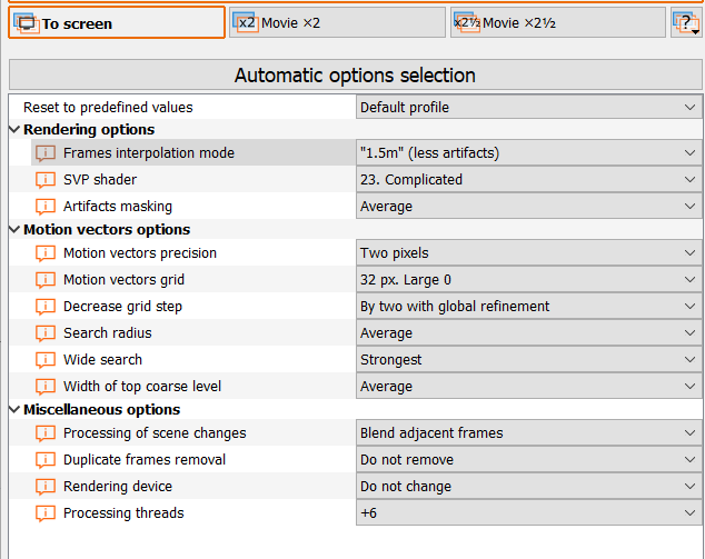

I have the settings almost to what i want. I know for sure 1.5m mode is the best for me.
Which other settings should i change to reduce motion judder?
I have no clue what any of the motion vector options are, just copied what i found online...any I should change?
btw i normally have the precision on one pixel, just changed to two.
Screenshot_1.png, 28.56 kb, 634 x 503

That's because you're using SVP Shader = Complicated. If you want to reduce artifacts, use standard shader, and change Frames Interpolation Mode to maximum fluidity option which is Uniform, I have these settings for 1080p, test them:
Uniform
Standard
Strong
One Pixel
28px. Large 1
By two with local refinement
Large
Strongest
Large
Blend adjacent frames
Do not remove
Do not change
+6
For 4K HDR content I have different settings, if you're interested let me know, but test the above for 1080p content.

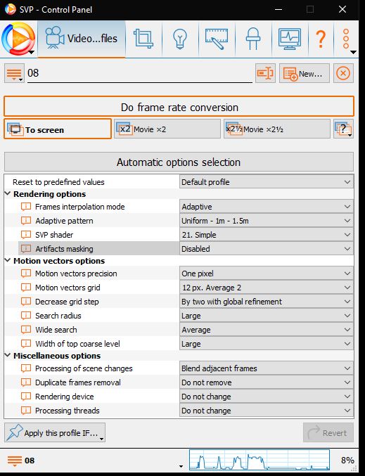

Uniform is too artifact heavy. Why not to try new tech ? Adaptive with 21 default shader that will switch to 13 (recently improved) on complex scenes. Whats your hardware ? As bonus you can also OC monitor to 72 Hz (x3) / add custom mode 48 Hz (x2 fps)

But I will also test out the adaptive with the simple shader to see what it's like

5 (edited by dlr5668 11-06-2019 13:34:44)
Re: Reduce motion judder?
Alexander09138 wrote:
Thanks for the responses. I have a 144hz 1440p monitor, i7-9700k, GTX 1070 and 16GB of RAM. I use SVP at 144fps now, but I can't stand the soap opera effect, which is why i use 1.5m...perfect balance IMO.
By the way, the type of media I watch is often tv series (usually 1080p) and films.
I rewatched Expanse bluray recently with this override and 72 hz (middle ground between soap and judder like original) and it was amazing
https://i.imgur.com/MUWudzC.png
C:\Program Files (x86)\SVP 4\script\override.js
smooth.scene.limits.m1             = 800; //1600
smooth.scene.limits.m2             = 1400; //2800
smooth.scene.limits.scene         = 2000; //4000
analyse.main.levels                 = -1;
analyse.main.penalty.lambda         = 14.0; //10
analyse.main.penalty.plevel         = 1.4; //1.5

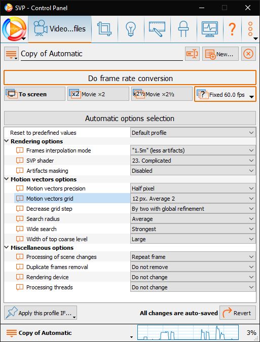

Still getting judder in a panning scene.
Tried the settings above and the one in the screenshot (below).
Not sure how to work the script, I just copied the one above in the SVP scripts directory.
Artifact masking does not help.
Tried changing Search Radius to Small and Motion Vectors grid to 16x.
Tried the 13 Automatic profiles.
Does it matter if the refresh rate is to screen rather than Fixed 60.0 fps?
Intel i5 8400, GTX 1060, Win10x64. Lav 0.74.1, madvr 0.92.17, MPC HC & BE x64. 2 displays, Dell 2209 WAf, Benq W2000 (HT3050).
01.JPG, 84.79 kb, 513 x 675

Downloaded the file. Tested at 72Hz on both displays.
There seems to be some minor judder/artifacts at second 4 (around the main character), and the next second 5 on the left side of the face (around the ear).
The rest is too fast to notice anything wrong, but not very smooth.
@dlr5668 what are the rest of the settings in the screenshot?
Regarding the script, do I just copy it in the SVP scripts folder?
Haven't got a camera but from doing some research 1080p DLP projectors can be overclocked up to 75Hz, but skip frames.
I don't have a good knowledge of SVP, but I played around with the options and the judder seems to come if interpolation mode is set to anything other than Uniform or Adaptive>Uniform, and/or Artifact masking is set to Strongest.
60FPS does not seem to differ from 72FPS (on the monitor).
Used the settings in the attached screenshot and had no judder in the LD&R test scene, but the panning is smudged.
Is it possible 60 or 72FPS is not enough for a smooth and clear transition in this scene?
