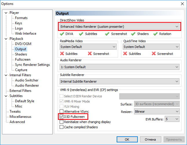

One of smoothest renderer is EVR CP in PMC-HC player. You need to enable D3D Fullscreen option and playback video at fullscreen. It is like example of smoothness. Try to compare how it looks and how tearing test line moves.

One of the smoothest renderers is EVR CP in PMC-HC player. You need to enable D3D Fullscreen option and playback video at fullscreen. It is like an example of smoothness. Try to compare how it looks and how tearing test line moves.
I tested out your suggestions and MP-HC 64-bit is definitely smoother and the tearing line moves smoothly, without skipping or jumping. According to the statistics, it's not 0 in jitters but I don't even see the lags at this point.
