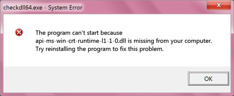

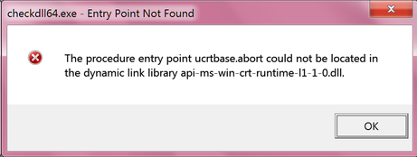

I've attached the two errors I normally get.  Taking the api-ms-win-crt-runtime-l1-1-0.dll from the SVP program folder and adding it to the MPC-HC program folder (which is where I have avisynth.dll located) then results in the second error.  And to clarify, interpolation doesn't occur in both instances of when the error is present.
Interestingly, if I use a newer version of api-ms-win-crt-runtime-l1-1-0.dll from a recent (though not the newest) version of streamlink, the second error message does not come up at all...but interpolation still does not occur (SVP just says "No active playback" no matter what).
Also it seems like mpv actually can run and play fine with SVP closed, but with SVP it gives the same aforementioned error messages and also automatically closes a second or so after starting playback.  Similarly, using that newer version of api-ms-win-crt-runtime-l1-1-0.dll from streamlink will also result in no error messages appearing when SVP is open, but it'll still close after a second of playback as long as SVP is open.
