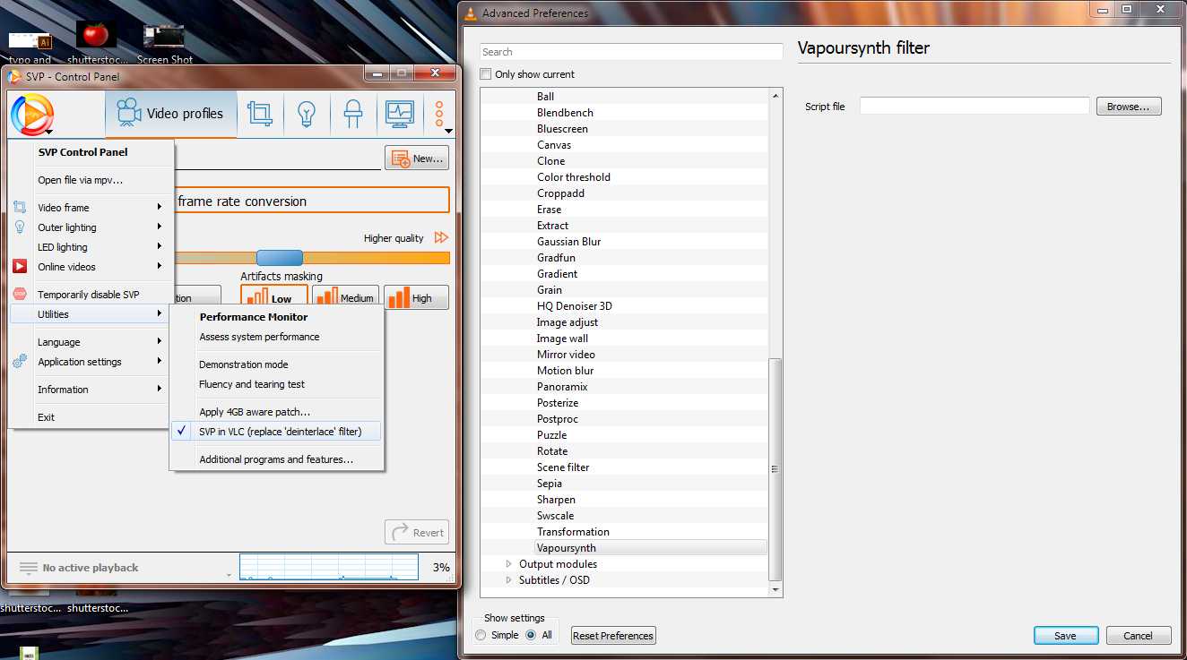

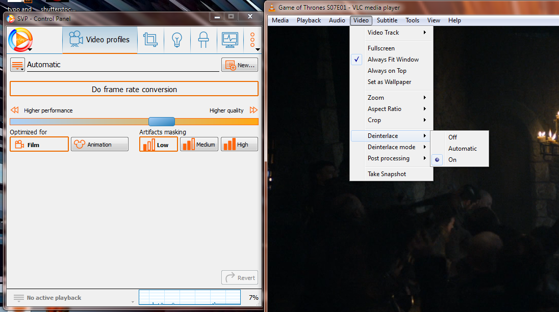

just purchased SVP to use for vlc movies @60fps, I followed all steps from the website, with current version of VLC: 2.2.6 umbrella 64bit as supported from the svp website...
I run vlc as admin always, updated the security settings for the "video filters" folder to full control as attached, the vapoursmith is read by vlc and in the video filters folder, I turn the deiterlace to on...what more do I need for it to work? I have attached screenshots for more details...

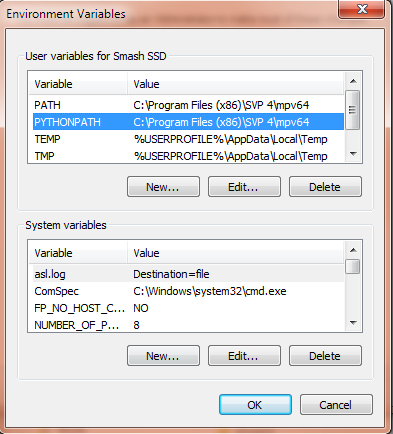

11 (edited by khaledsmash 20-07-2017 11:34:25)
Re: No active playback with vlc
double check that you set PYTHONPATH env variable
see the last advise on that page
yes it is
