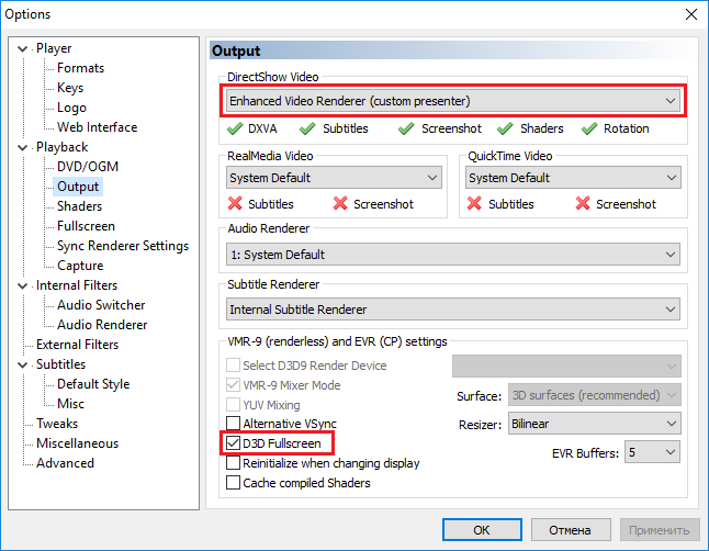

If you are using EVR then enable D3D Fullscreen option. See video in fullscreen mode.
Are the frame drops still here?

Sorry for the late reply. Unfortunately, d3d fullscreen causes black screen for me.
