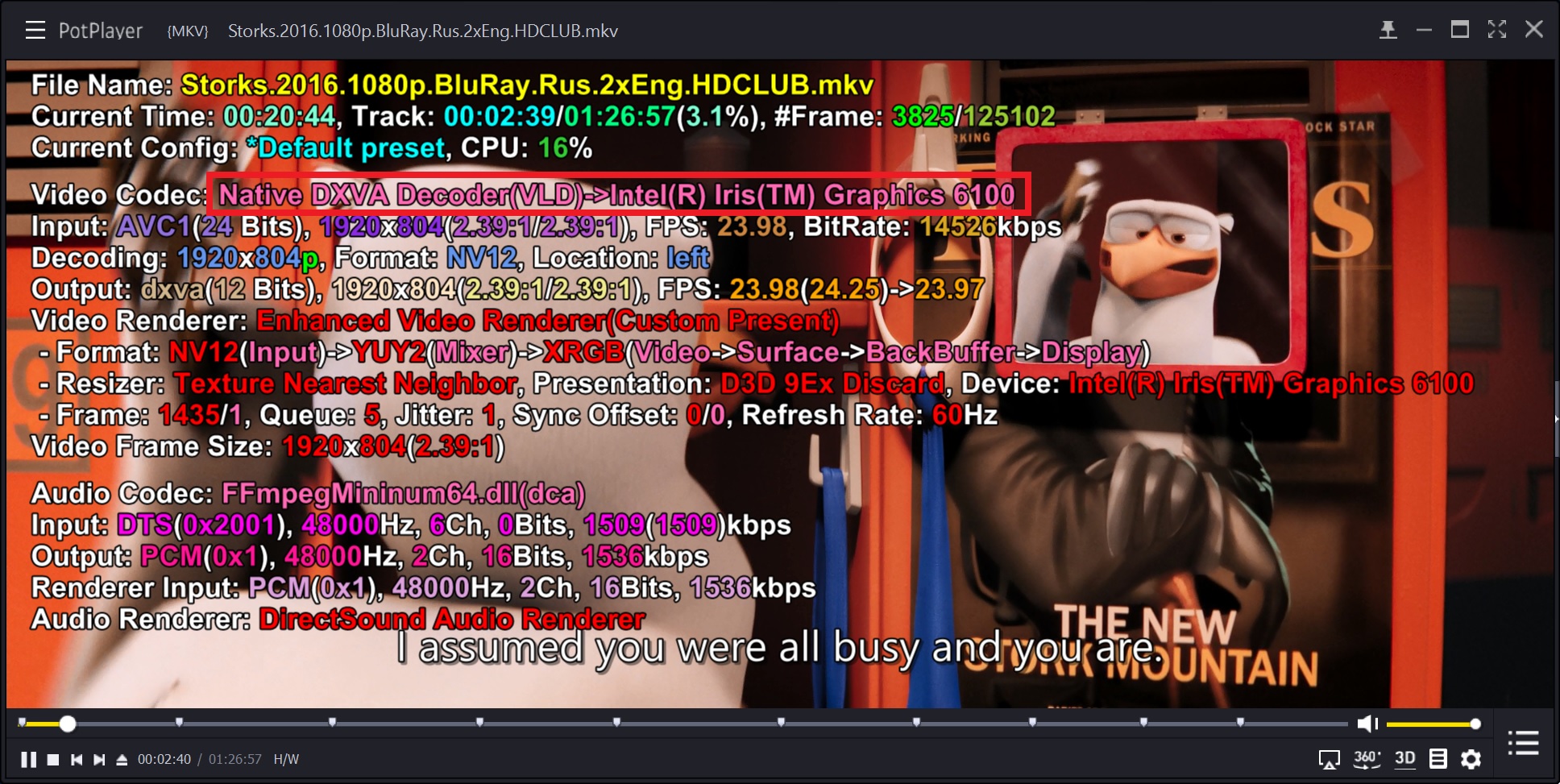

Re: PotPlayer freezes when playing MKV file with NVIDIA CUDA
I don't know. With the same settings I see DXVA is working to me.
http://www.svp-team.com/forum/misc.php?action=pun_attachment&item=4473

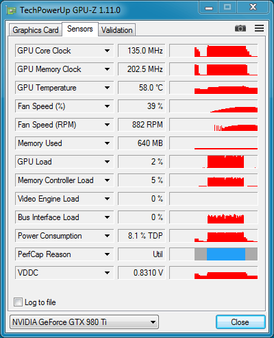

GPU load is not the same as HW Decoder (Video engine) load. They are different blocks of graphics adapter.
Just the picture of GPU-Z from Internet.
