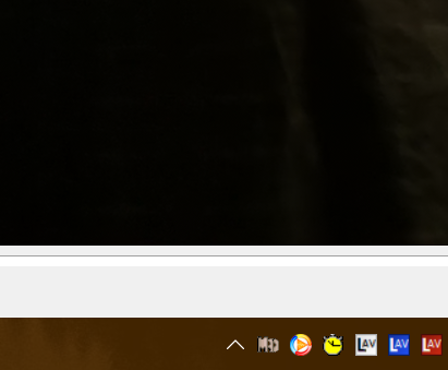

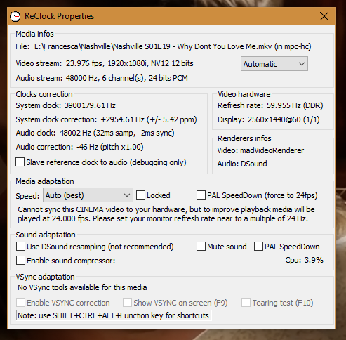

Can you attach ReClock's screenshot when icon is yellow?
Re: Reclock yellow icon
Here you go:
Screenshot1.PNG, 114.69 kb, 411 x 339
Screenshot2.PNG, 76.42 kb, 493 x 484
Looks like ReClock is working: Audio clock is 48002 Hz (not at 48000). So video and audio run with ReClock slower a bit.
Yellow icon in your case means all is good. wink
