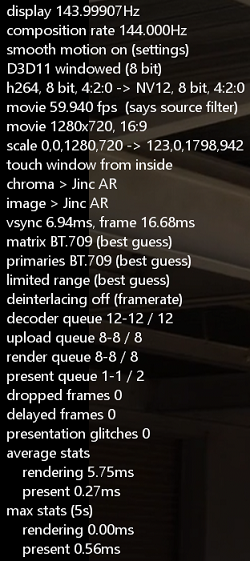

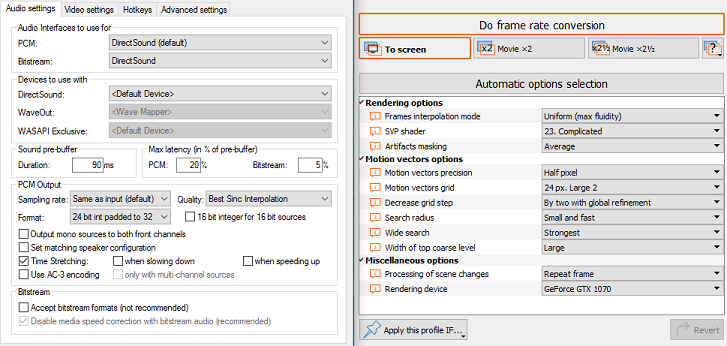

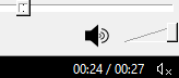

When playing videos using MPC-HC, the audio continues to play to the end, but the image last rendered freezes within the last second before playback completes. However, the player itself does not crash, nor does it freeze, this only happened to the video playback, either in fullscreen or windowed mode. Also, within this last second of playback, the seekbar icon jumps to the end, which may or may not be related. Attached is a gif of the icon skipping during  playback.
I've tested .mp4 and .mkv files, but the same thing happens to both.  To verify the integrity of the files, I tested them on vlc, but they worked fine there.
Is it possible that one of my settings in my SVP+madVR+ReClock setup is interfering with the video playback? Any help would be appreciated.
For reference, I've also included my SVP, madVR, and ReClock settings.
