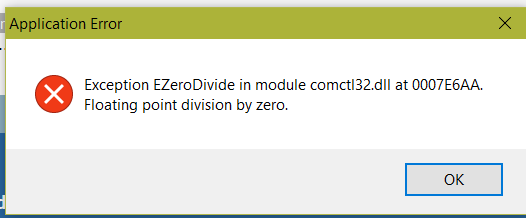

In the attachment you'll find mediainfo txt which shows result 29.970 fps, which is wrong because the show was recorded in UK broadcast 1080i/50. I used to see the exact same file with SVP 3.1.7 with the TV set to 50ha and frame doubling overriding the auto detection. I tried to download SVP old version but now it gives me error (see attachment).
What you see in the log is a wrong framerate what I need to know is a way to let SVP think that the file is 25fps
