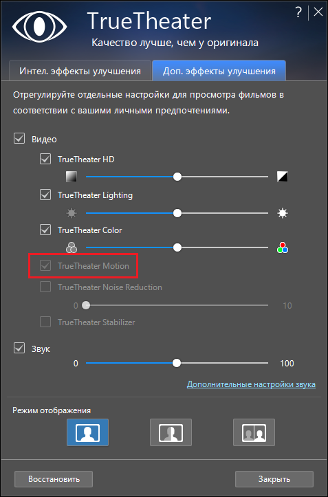

I've just tried PowerDVD 16.
TrueTheater Motion disabled when I open Bluray whole and it can't be enabled.
But I can enable TrueTheater Motion if I open one *.m2ts file separately from folder BDMV\STREAM at Bluray disc.
Such way you can watch your BD without menu but with a little smoothing by "TrueTheater Motion". Try it.
P.S. After update PowerDVD to Build 2011 the option TrueTheater Motion works another way: it still enabled when watching BD.
