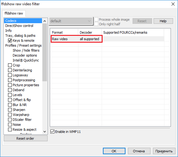

then open ffdShow raw settings and check at Codecs tab is Raw video format enabled to decode.
ffdShow_raw_codecs.png, 20.04 kb, 576 x 508
