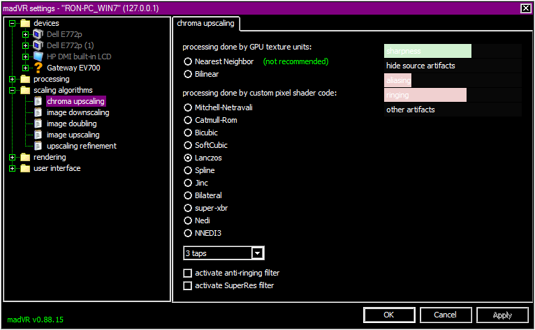

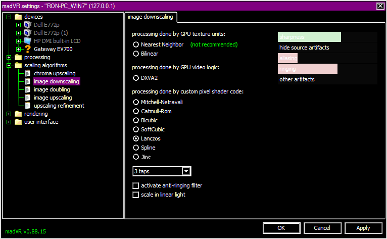

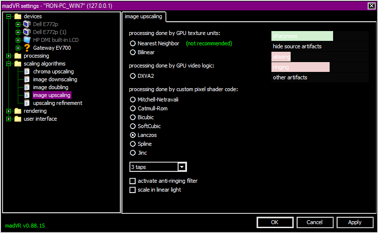

3 hours later than I hoped, I'm back!
The issue is, I don't believe PotPlayer has a built-in resolution changer like MadVR does, so using EVR would prevent the use of MadVR's automatic resolution changer.
Anyway, about MadVR's upscaling, unless you're using a CRT monitor or an HDTV, 99% of the time the upscaling done by MadVR will look quite a bit better even if you use lower-end settings like Lanczos.  Try that with a 720p or lower resolution video and see how the quality compares vs actually setting your screen resolution to 720p or whatever.
Setting your scaling algorithm is easy - just go into the MadVR settings and, under "scaling algorithms", set the scaling to whatever you want (start with something more basic like lanczos) for every single sub selection where it's an available option (should be in "chroma upscaling", "image downscaling", and "image upscaling".
Oh, and while comparing scaling algorithms and the like. it might be wise to disable SVP if the frame rate issue gets in the way.

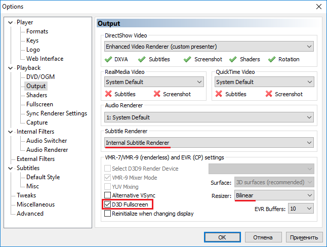

Re: My FPS while using SVP 4 keep rising higher than 72fps. Please HELP!!
still experience some stutter now and then while using EVR. Any tips?
Use EVR D3D Fullscreen option to get no stutter in Fullscreen mode.
EVR_D3D_Fullscreen.png, 24.01 kb, 646 x 488

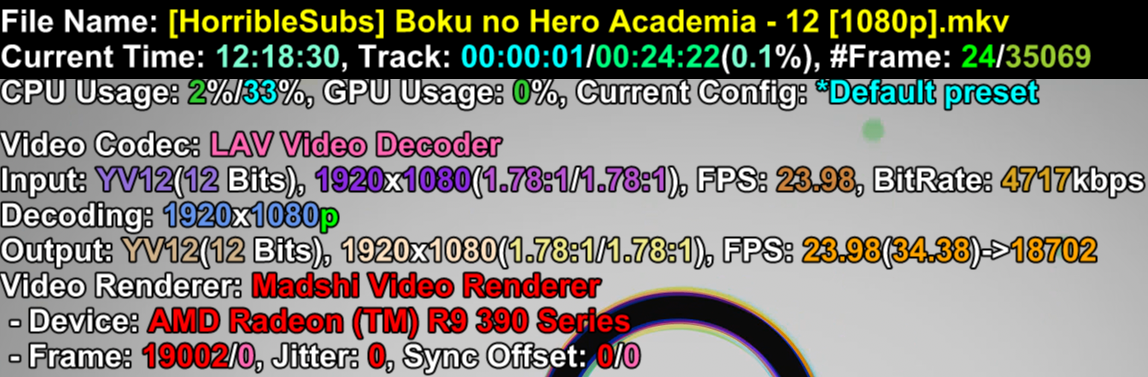

Thanks for the tips, but the problem is that madVR is greedy and won't hold the frame rate I wish it for, and therefore it decide to goes crazy mode with fps. DO you have any solution to how I could make madVR only interpolate 72Hz?

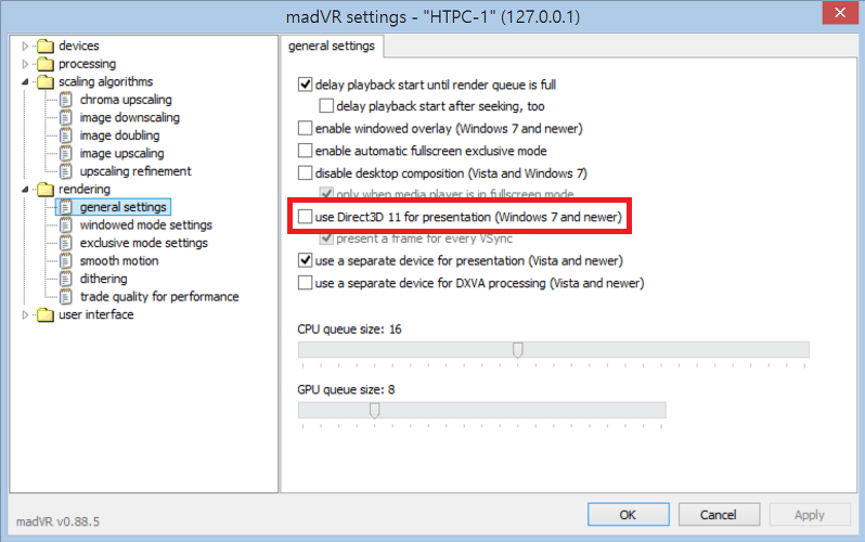

Quick question - what's your CPU?
TayyabKhalid wrote:
You dont use madVR. Do you?
I have MadVR, but I don't use it for performance reasons (I only use integrated Intel graphics).
Anyway, have you tried enabling "use direct3d 11 for presentation" in MadVR?
image.png, 144.31 kb, 798 x 500
