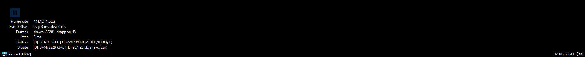

I have been having this issue so long now, and I have only ignored it, but after watching a anime which had crazy fights I noticed that it starts lagging since my shitty fps can't stay at 72fps and decided to jump over it and it even goes to crazy numbers like 100-200. Someone please help me solve this, so I can enjoy using SVP again. Only because of this I am unable to enjoy anything, and if I turn off SVP its like its lagging, since i've been so accustomed to using SVP i can't live with out it now! sad
I tried with both MP-HC even same result as with Potplayer (My main player).
Here is two picture corresponding to both players

Here is for potplayer: http://imgur.com/GpJU59b

I see. It is not normal. Please send us bug report just after you will see huge framerate again.
SVP tray menu - Information - Send problem report...
We will search what the problem in your logs.
