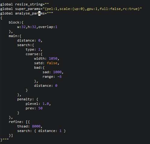

(Below I attached my radeon system and SVPAnalyse parameter options).
Thanks in advance.
analyse_options.PNG, 13.66 kb, 497 x 478

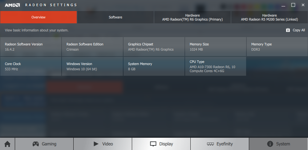

radeon_crimson.png, 160.76 kb, 1000 x 489

Just to clarify, does this system have a stand-alone discrete GPU and an APU, or does it only have the integrated graphics built into the APU?
It has stand-alone GPU which linked with APU. From the pic of system, the discrete is R6 Radeon (primary) while in APU is R5 M200 (linked).
But the memory is shared with GPU (I don't know with which GPU), so is it standalone or integrated?
