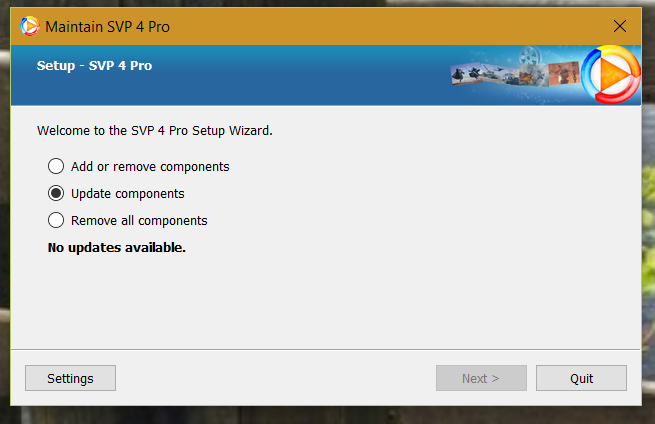

> "svp4-maintenance.exe" it says no updates are available
I can't imagine how this could happen IF you really don't have SVP .73 and madVR .17 installed (in this case "installed" == "listed in the components.xml file")

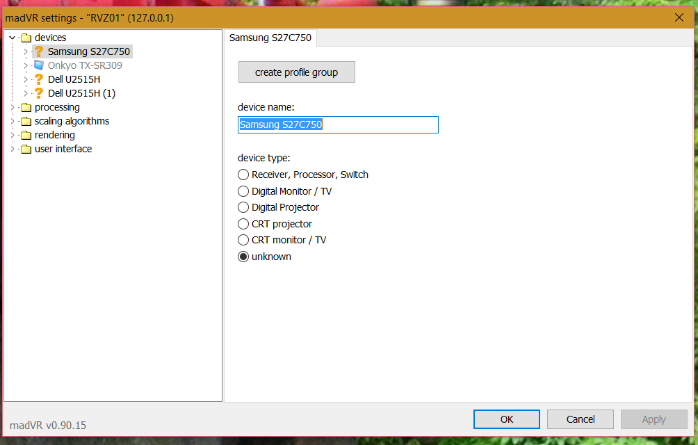

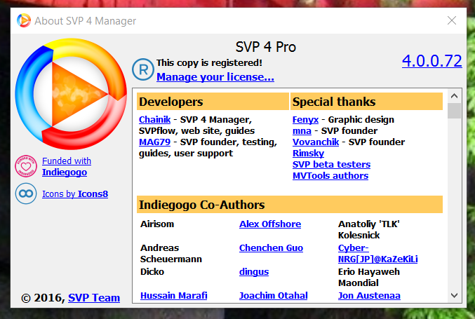

Thanks Chainik, It's funny because Madvr folder inside SVP shows last version and even "components.xml" shows SVP Manager (Pro) application Version 4.0.0.73 smile
But when SVP 4 Manager is launched it's the previous version (together with MadVR old version V. 0.90.15 (127.0.0.1)): mad
Date and time: Thursday, 7 April 2016 21:13:34 ora legale Europa occidentale
SVP version: 4.0.0.72/Windows
Screenshot1.PNG, 146.71 kb, 677 x 455
Screenshot3.PNG, 94.33 kb, 655 x 424
