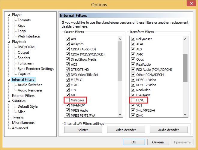

Well here's something interesting. Enable System-Tray for LAV Splitter, Audio, and Video (all 3 in MPC, and all 3 that are installed separately via SVP Update).
Run a video, and you'll see in the system tray icons if you double click them... LAV Video and Audio are both using Version 0.68 (the latest one that SVP installs), and LAV Splitter uses 0.66 from MPC directory.
I added LAV Splitter in MPC External Filters and set it to PREFER, and it still uses 0.66 which comes with MPC. It doesn't want to use the newer one that installs with SVP.
I'm not sure if this is relevant at all, but might help identify the issue maybe?

Blackfyre
Just remove format from MPC-HC inernal filters list and it will be opened by external (LAV) splitter, registered in your system.
At the picture I allow to use external Splitter for Matroska and external decoder for HEVC format.
MPC-HC_external_splitter&decoder.png, 31.92 kb, 660 x 500

Re: Recent crashes
Blackfyre
Thanks MAG79
I'll give that a try tonight. By the way since you guys bundle the latest MPC & LAV Filters now with SVP 4 Installer, you know when it asks (should SVP Installer change MPC settings...), it should remove/un-tick all INTERNAL filters, so it uses the latest LAV Filters that come bundled with SVP.
