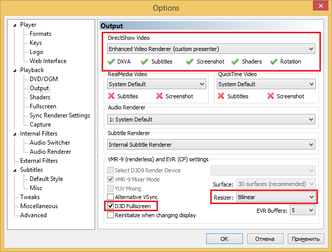

In case with AMD Radeon R9 2xx You can change renderer in MPC-HC. madVR causes the errors. I recommend to use EVR Custom with D3D Fullscreen option enabled.
MPC-HC - menu View - Options - Output

Yeah I have an AMD 290X. But it doesn't seem to be madVR since I already use Enhanced Video Renderer and the crashes still occur.
I didn't have D3D Fullscreen enabled though, so I'm trying that now.
