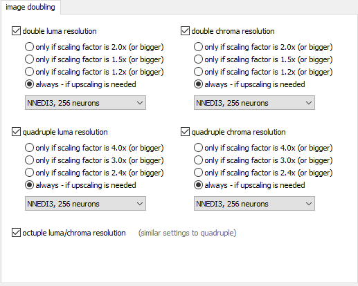

The odd thing is that when I scale the window down a little to take up around 2/3 of the screen, gpu usage is only at around 40-50% but past some certain point, it just jumps to the 90's. Furthermore, when I turn the resolution of my monitor down to 1920 x 1080, I can basically use max image doubling settings and chroma doubling settings at 96fps (see attached image) and the gpu usage is only at around 60% (2-3 frames are still being dropped per second for some reason).
Thank you for your help!
abc.png, 12.97 kb, 517 x 414

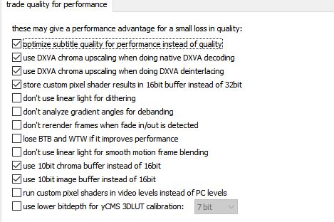

How about tweaking the performance tab in madvr?
madvr_perftab.JPG, 46.19 kb, 469 x 312
