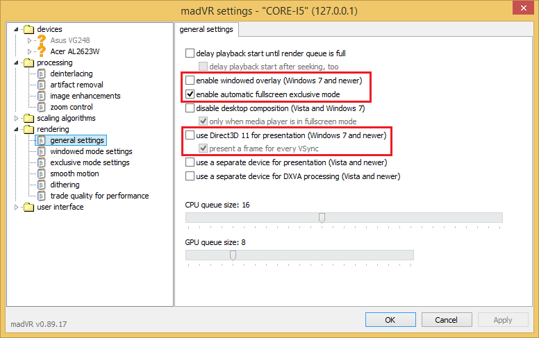

So. I don't know about decoding settings in Kodi. In madVR check Automatic Fullscreen Exclusive mode option and another options in the general settings tab. Try to enable them. They must help.
I use Exclusive + use Direct3D 11. Some times ago I used windowed overlay.
madVR_options.png, 36.48 kb, 776 x 487

Fullscreen exclusive and Direct3D11 were already enabled (apparently this is the default) in my madvr settings.
