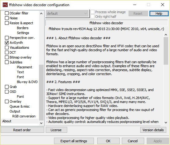

The ffdshow version:
ffdshow tryouts rev4534 Aug 12 2015 21:30:00 (MSVC 2010, x64, unicode, r)

about_ffdshow.png, 33.26 kb, 554 x 473
