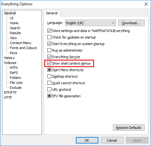

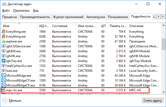

Re: SVP 4 not detecting video
cookieboyeli
If you launch "Everything" from tray icon then it open files with admin rights. It is bad.
See picture (Andrey = user; СИСТЕМА = system). But only the first time.
I did change one Everything setting (see another picture) and restart windows then situation became as must be: MPC-HC open video from Everything with user rights. wink
Try it.
