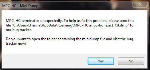

With the new version of SVP and AVS+, MPC-HC occasionally crashes. It crashed regularly before, but it crashes in a way it didn't before. See attached image.
Also, this new AVS+ MT corrupts the image when using NNEDI3 filter and instantly crashes when using EEDI3 filter. Both work fine with AVS 2.6 MT.

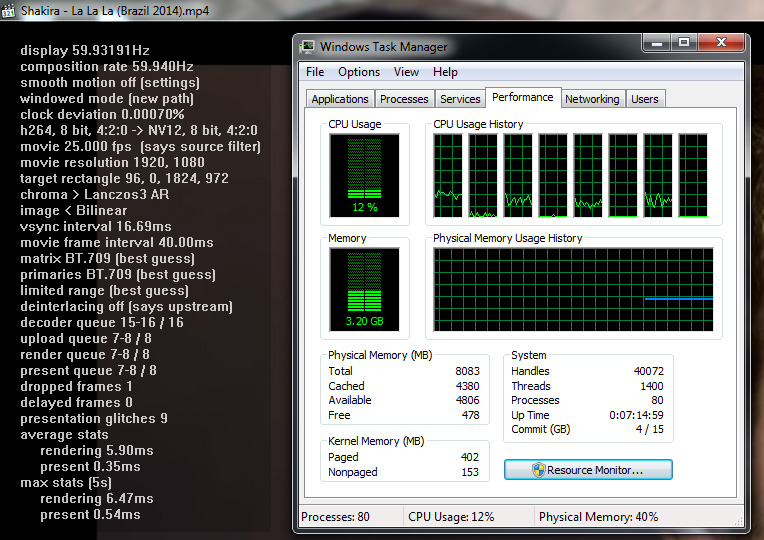

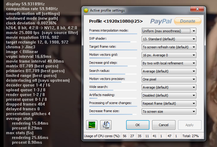

147 (edited by Mystery 03-05-2015 02:01:46)
Re: New version of SVP?
Right now I'm playing the Shakira La La La video with rendering time of 10ms, max stats 20ms with CPU usage @ 40%. No dropped frames, but the max stats twice higher than the rendering time is abnormal and doesn't happen without SVP.
When I get occasional jumps at 75ms, it may be because the CPU peaks at 100%. But when it plays stable like this, something else is going on.
Here's some data you can work with. Attached screenshots show stats with and without SVP.

Mystery
SVP needs more GPU power form time to time
SVP needs GPU power for every frame if you have GPU-acceleration option enabled in SVP.
if madVR eats 15 ms on every frame rendering it leave only 16-15 = 1 ms to SVP to calculate and compose the frame. Do you think it is enough to SVP? I think No. Try to disable GPU-acceleration. Try to use EVR instead madVR. Use GPU-Z to control GPU load.
Your GPU is AMD Radeon HD 7660M?
Did you see that wiki-page: GPU Compatibility?
149 (edited by Mystery 03-05-2015 04:59:44)
