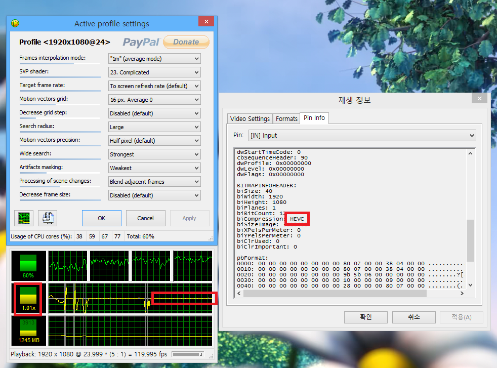

It is not specific codec or resolution matters directly because it is not SVP that handles decoding.
What only and always matters is that your PC performance can handles both workload from the decoding and SVP process.
Using better codec or HW to get better decode performance is one of obvious asset to improve your chance to success. (Using up-to-date SVP or adjust SVP option also can make difference)
Like the 0.png I attached. (its FHD HEVC demo video)
LAV filters is now v0.64.4 and got several improvements over 0.58.1. It wouldn't be hurt to try is  neutral
