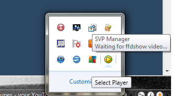

SVP manager say all the time - Waiting for ffdshow video...  but nothing happens.

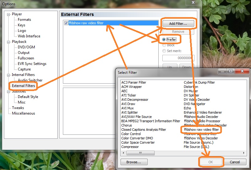

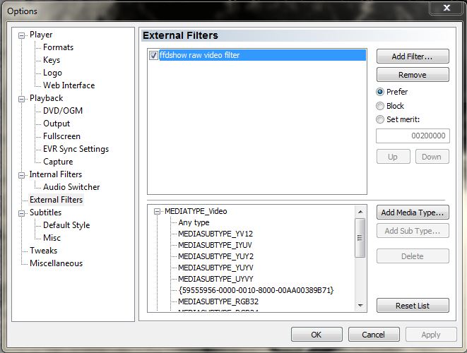

In XP I did not have this problem but I switched to Windows 7 and could not having SVP working with ffdshow raw using a different decoder (Cyberlink with HAM in my case).
Seems that in Windows 7 you have to add the ffdshow raw decoder in external filters in MPC-HC too aside from the decoder otherwise it doesn't work. Strange that in XP no need to do that, I just added Cyberlink 10 but didn't added ffdshow raw and it was working fine smile  but no HAM of course  big_smile

tman wrote:
to add dd the ffdshow raw decoder in external filters in MPC-HC
http://www.svp-team.com/forum/misc.php?item=339&download=1
mpc-ffdraw.jpg, 156.58 kb, 818 x 555

Catching occasion I'd like to add sth to topic. New SVP came up and I make recently another trial with no success.
When video is playing and SVP says it waits for ffdshow, it also is frozen and when I right click on it nothing happen. Earlier I thought it is supposed to be frozen to ensure no changes during playback but now I know it is a bad sign. Moreover when I play video with some very old Widezu's scripts and SVP is launched it seems like SVP override avisynth script but doesn't apply its own script, only freeze and waits for ffdshow.
To summarize it knows that ffdshow is running but it stuck in some moment when talking with ffdshow.
Any hints what could be wrong (for me and few other people I found with this problem)?

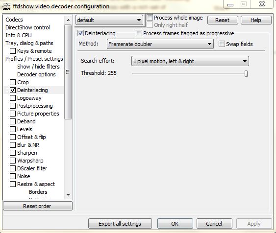

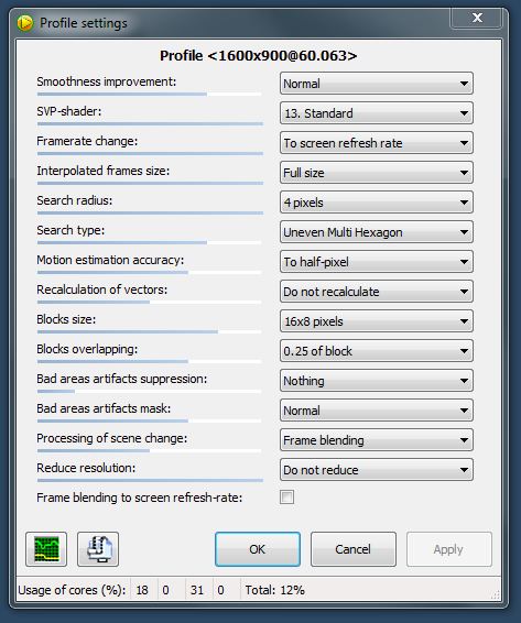

Hmm. I'm still receiving a "Waiting for ffdshow video" message.
Here are some screenshots that show the settings I'm using.
If anyone has any suggestions for me, I'd love to hear them! Thank You!

2 more screenshots.
Note: I'm using SVP to get the "Soap Opera Effect" on the videos I watch so the settings I pick were to try and get that.

Re: Waiting for ffdshow video... issue
Why you using deinterlacing  tab? Disable it. And make sure ffdshow is really running - check if there is ffdshow icon in tray or right click on video and check what filters are used.

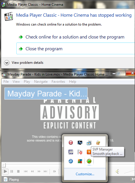

dzid_
Thank you for responding! I uncheked deinterlacing.
Now everything is responding, but the Media Player Classic Home crashes when the SVP smooth playback starts.
new.png, 128.24 kb, 471 x 637

tman
Can you show details of this error?

@MAG79 the error message  is:
Problem signature:
  Problem Event Name:    BEX64
  Application Name:    mpc-hc64.exe
  Application Version:    1.5.1.2903
  Application Timestamp:    4d6bfe92
  Fault Module Name:    StackHash_1dc2
  Fault Module Version:    0.0.0.0
  Fault Module Timestamp:    00000000
  Exception Offset:    0000000000000000
  Exception Code:    c0000005
  Exception Data:    0000000000000008
  OS Version:    6.1.7601.2.1.0.768.3

tman
Is it a x64 build of MPC-HC?  hmm
SVP is working with x32 players only (and with x32 builds of ffdshow).
i just downloaded the x32 version and it works perfectly! thank you for all your help. your program is great!
