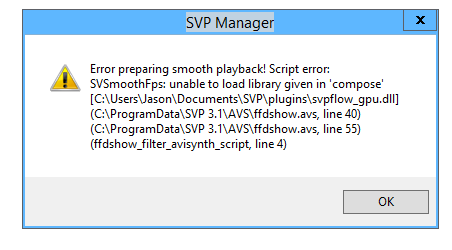

Hi everyone.
I already tried to reinstall drivers (Nvidia GTX 780) and completely reinstall SVP.
Any ideas ?
Capture.PNG, 11.1 kb, 452 x 250
so try harder big_smile
svpflow_gpu.dll can't be loaded IF opencl.dll is missing in windows\syswow64 (or windows\system32 on 32-bit Windows)
don't try any "beta" drivers, use WHQL versions only

I have both of these files. I have the version 340.52 of my GC driver.

well...
why so strange installation folder - c:\users\jason\documents\svp ?
is "c:\users\jason\documents\svp\plugins\svpflow_gpu.dll" really exists?

I was thinking it was right problems so I installed it on a folder that don't need any rights to execute something or modify something etc. But it was doing the same when it was on C:\Program Files (x86)\SVP
And yes it exists

If you'll run Dependency Walker and open "svpflow_gpu.dll" it'll show what is missing in your system.

It woooooooorks ! I found a file "OpenCL.dll" into the SVP folder. I just copy and paste it into different folders like the "plugins" folder, the "system32" and the "SysWOW64" folders. And now it woooorks !
