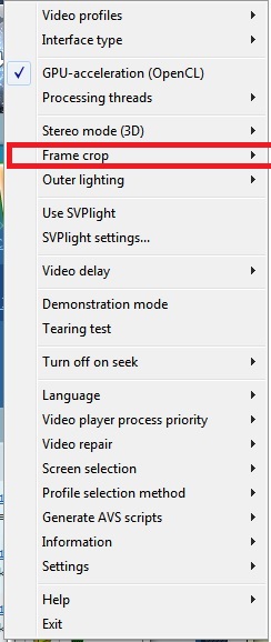

Do you disable frame crop setting?

5 (edited by mashingan 15-10-2014 22:28:22)
Re: SVP hides parts of the video
You must change your setting interface to expert (2nd from top).
http://www.svp-team.com/forum/misc.php?item=3271
Disable frame crop in that setting interface.
spvsetting.jpg, 43.68 kb, 244 x 578
