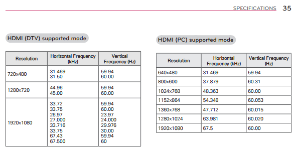

hmm
try to read full specs next time you'll buy something
http://www.svp-team.com/forum/misc.php?item=3196&download=0
from the "owners manual" from there
lg.png, 32.45 kb, 590 x 295

I actually saw that bit on the manual, it just struck me as flat out dumb that there wasn't a way to get a 120 Hz signal on a TV capable of showing 120 fps. Sorry if I give you the impression of someone stupid by asking a way to not get a huge disappointment each time I see the only TV upgrade I'll see in years. I may whine a LOT about import taxes, but that same TV you get for 800 dollars? Here it's over 1200. And of course, a 3rd world budget doesn't allow upgrading home electronics very often.

Each and every one of the at least eight different 120 Hz (or even higher) TV's from which I've been able to track down their manual, actually can only take up to a 60 Hz signal.

As I know no one TV can show 120 fps from PC. Maximum is 60 fps via HDMI.
But not all so bad. wink You can produce smooth 60 fps by SVP transmit that 60 fps to your LG TV and make them smoother by TV's TruMotion 120 Hz technology.
