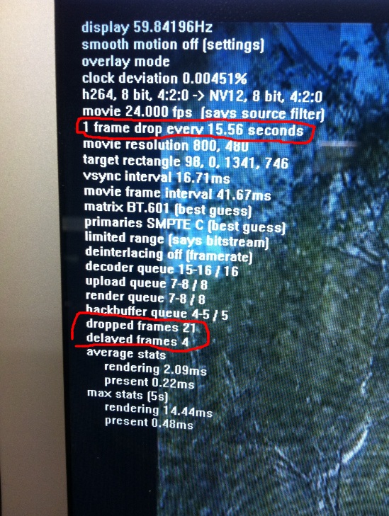

it looks my here dropped a frame every 16.xx seconds, much worse comparing to your every 54.xx minutes. Is there any options in madVR can improve this? roll
http://www.svp-team.com/forum/misc.php?item=3194
1.jpg, 208.83 kb, 549 x 729

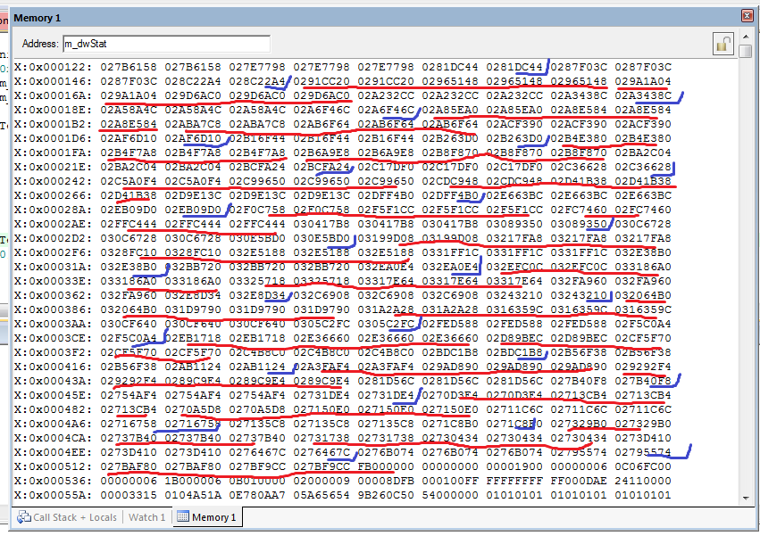

Here're two snapshot with ReClock.
figure 1 is as I expected aaabb sequence. every 5 frames are correct aaabb. I marked them with a blue angel.
http://www.svp-team.com/forum/misc.php?item=3197
but figure 2 is not. the red ones are aabbb.
http://www.svp-team.com/forum/misc.php?item=3198
ReClock-1.png, 73.74 kb, 859 x 609
ReClock-2.png, 93.84 kb, 851 x 601

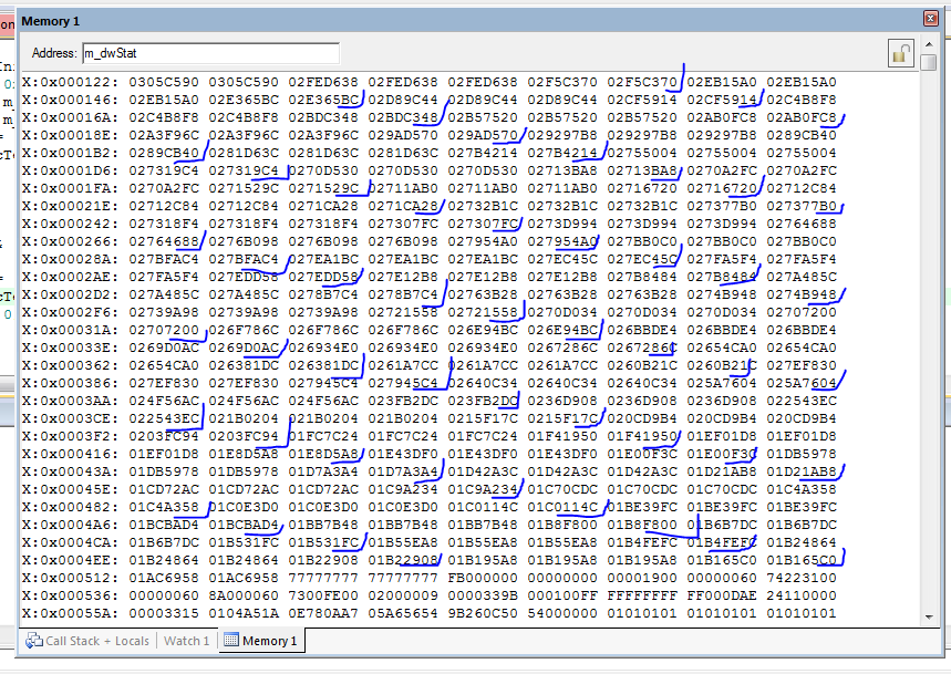

i have to turn off selectEvery script otherwise the frame sequence is totally corrupted. like this:
it looks ReClock has some logic to control how to duplicate the frames from 24fps to 60fps, and selectEvery would interfer with it.
http://www.svp-team.com/forum/misc.php?item=3199
ReClock+SelectEvery-1.PNG, 68.87 kb, 842 x 590

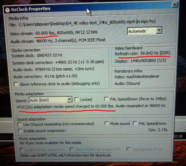

Enclosed is the snapshot of SelectEvery(2,0,0,0,1,1) enabled case.
http://www.svp-team.com/forum/misc.php?item=3200
1.jpg, 238.42 kb, 714 x 636
