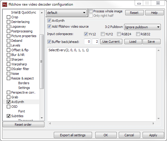

Yes. Exit SVP. Open ffdShow. Go to Avisynth tab.
write:
SelectEvery(2, 0, 0, 1, 1, 1)
enable option "Add ffdShow video source"
enable Avisynth option
OK
http://www.svp-team.com/forum/misc.php?item=3160
SelectEvery.png, 17.57 kb, 568 x 479

Re: how can I convert 24p to 60p without the smooth interpolation?
swiths
It will work till SVP is not loaded. When SVP will be launched it will disable user's avisynth-script and will use its own auto-script. After exit SVP user's script will be restored.
So, you don't need change anything else.

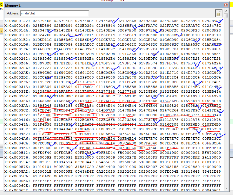

I've tried MPC-HC with AviSynth script: selectEvery(2, 0, 0, 0, 1 , 1) but the video cadence is not always as expected 3:2 style. After about 2 seconds, there's some incorrect cadences. Here is a snapshot. Each DWORD is a value generated from the frame content so that if they're duplicated, it means the frames are repeated.
Do you have any idea if I'm not using correct playback options like accurate/alternative vsync, or anything I can try to narrow down? roll for example, can we verify if AviSynth+ffdshow is doing the selectevery correctly? by dumping the frames to somewhere? Or it's related to the presentation during vsync?
swiths
If you want frame-accurate output then use ReClock. It can synchronize video framerate to display refresh rate by correcting speed of audio and video streams.
But frame time stamps marked red is abnormal in any case.

as to the red stamped frames, is that because of tearing? but I remember I was turning on vsync, accurate vsync , alternative vsync. hmm
I don't know is it tearing or not, but I see at your picture more than 2 identical frames at 5 positions.
alternative vsync
Use it if you really know what is it. I don't use it because I don't know. I use madVR's windowed overlay or fullscreen exclusive mode to avoid dropped frames.

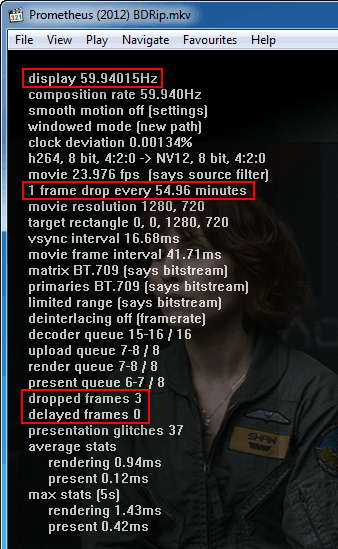

swiths
MadVR has useful OSD statistics by Ctrl-J hotkey. Especially about dropped and pending frames.
What renderer did you use before?

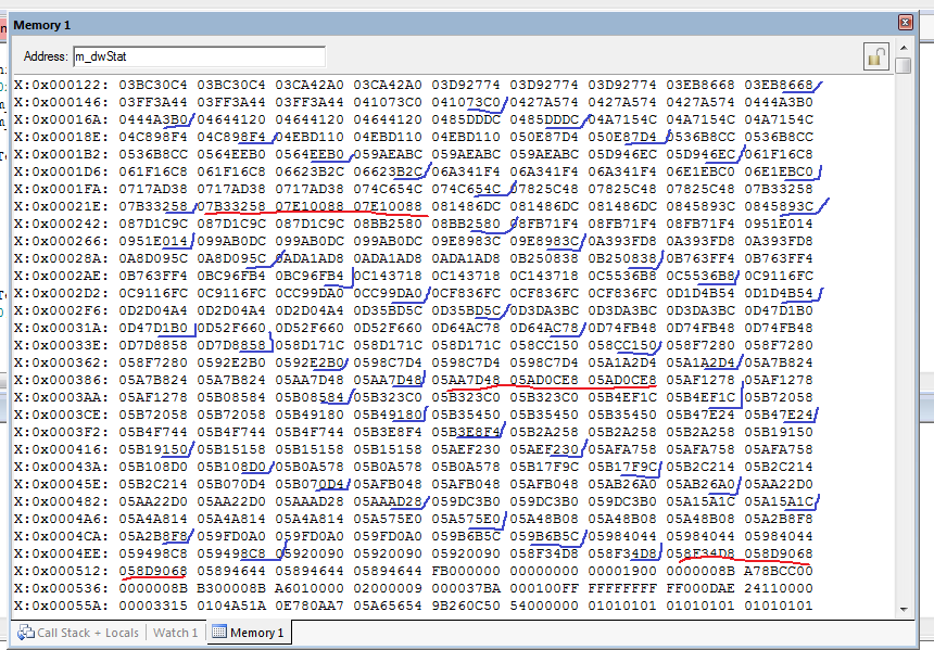

22 (edited by swiths 30-04-2014 08:24:53)
swiths
I was using 'Enhanced Video Render(custom presenter)'.
[update]
haven't got chance to try ReClock but it looks MadVR has much better results now...
almost 247 of the total 256 frames are correct aaabb(3:2) cadence, also the red frames are not so odd as they're duplicate of previous or next frames.
So it seems it's the render/presenter's fault, instead of ddshow codec or AvisSynth's ? roll
Yes. I agree with you.
This renderer sometimes produces dropped frames. One of method to avoid drops in EVR CP is to enable fullscreen D3D.
This picture looks better wink
Can you tell what tools are you using for that (Memory 1 / m_dwStat)?

Instead of ReClock you can also switch your display to custom refresh rate. For this you need to create custom mode and add it to list of display modes.
I added 59 Hz mode and costomized it manually in NVIDIA control panel as close as possible to 59.94 Hz
http://www.svp-team.com/forum/misc.php?item=3189
madVR_stats.png, 67.75 kb, 338 x 549

swiths
that is a memory dump debugger window running on a capturē device.
i am using a 60hz panel and madvr shows its 59.xxxfps. need i customize a 59.xxx hz refresh rate?
