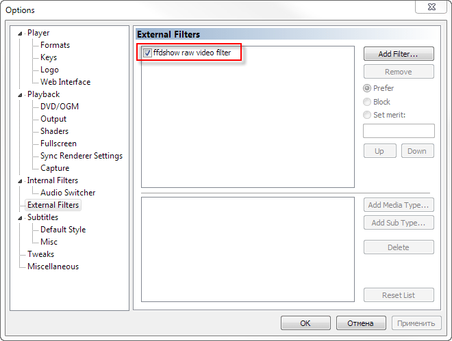

If you downloaded SVP Full bundle then MPC HC must be customized for SVP. SVP Core bundle needs to be configured manually.
http://www.svp-team.com/forum/misc.php?item=3182
More info: FAQ # SVP Manager tells "Waiting for ffdshow video..."
MPC-HC_external_filter_ffdShow.png, 14.81 kb, 660 x 499
Re: Not working, framerate is the same watching .mp4 or youtube in MPC-HC
I downloaded the full bundle but in External Filters there was nothing there, I added the ffdshow raw video filter like the screenshot and tried again but still the same message.
