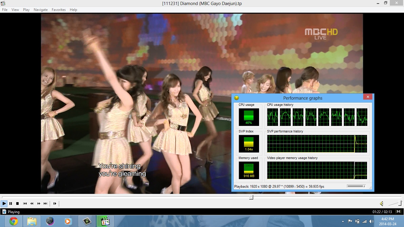

I downloaded the latest version of madVR. The new NNEDI3 scaling looks really interesting! Unfortunately, it causes a blue screen crash & reboot on my computer!
With the new version of madVR, one of the 2 HD videos is now playing fine. Here's a screenshot of the 2nd video.

Mystery
CPU usage 46% and SVP-Index 1x are good values. All must be work fine without lags.
Did you touch madVR settings? Then reset them to defaults.
NNEDI3 is not compatible to recent NVIDIA drivers. NVIDIA broke smth in it. Use NVidia 327.23 drivers (or older).
Look to your GPU load via GPU-Z.
Your screen size 1366x768?

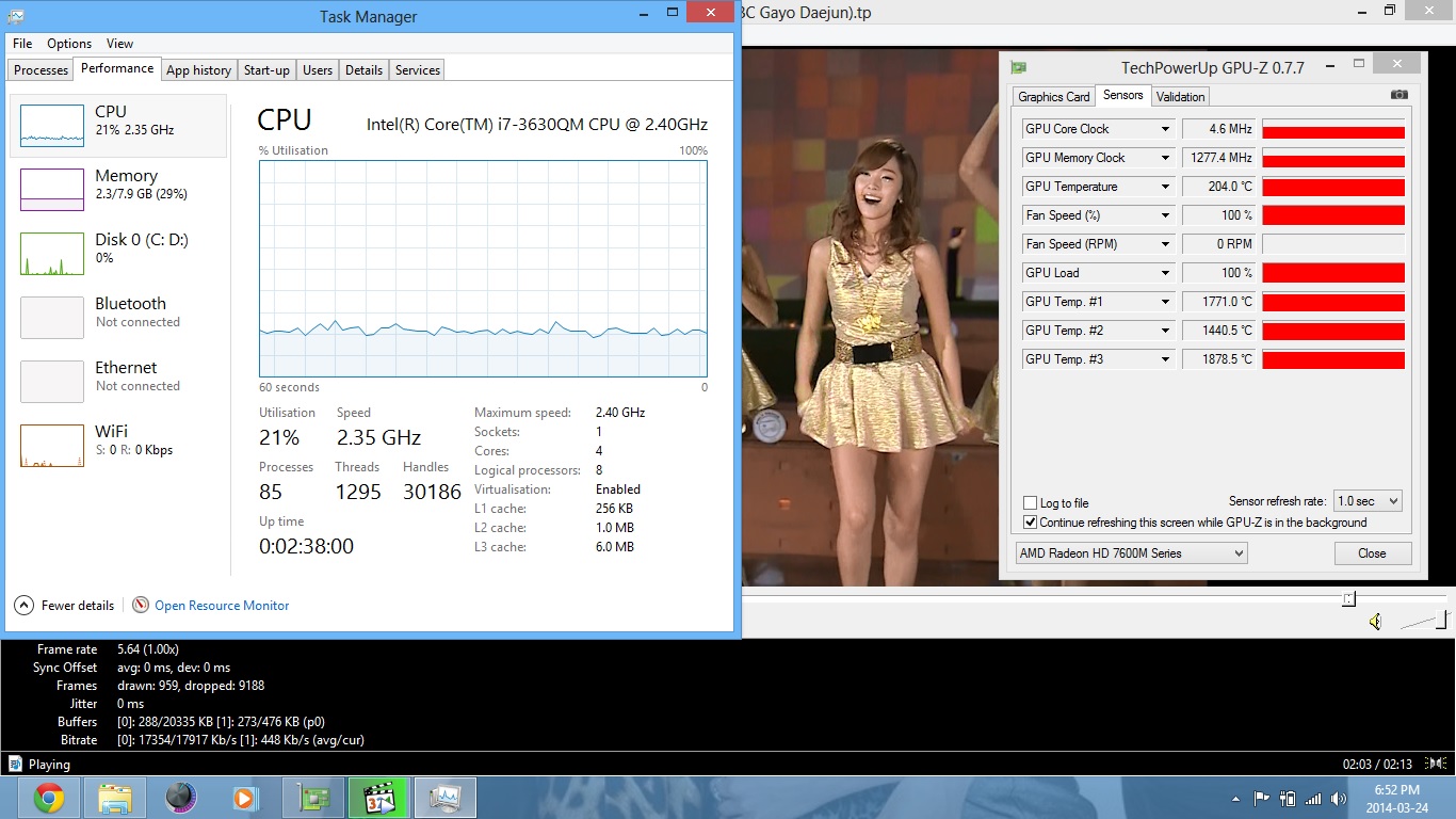

Here's another screenshot with SVP closed. Only madVR is running.

GPU load 100% at your screenshot hmm
You need to reduce madVR settings. Your GPU is weak to perform all computations.
