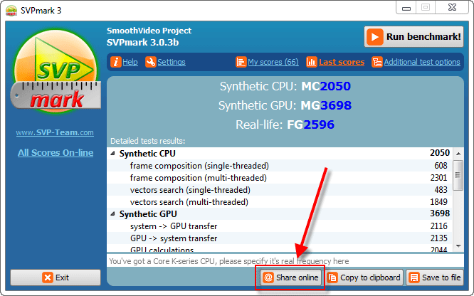

How do I upload results?
Re: Still having issues with blurays and 100% cpu load
SVPmark - Settings - input your user Name, Password from this forum - Check user - Run Benchmark! - [wait] - Share online
How do I "share online"?
http://www.svp-team.com/forum/misc.php?item=3032
SVPmark_Share_online_button.png, 26.87 kb, 666 x 416
11
It's grayed out, I have my username and pass in there. What am I missing?
"Check user" button near login/pass at Settings page
13
Yeah I did that, still grayed out.
JT!
Then use 'Copy to clipboard' button and post results here. I think it will be enough to me to say what is the problem.
