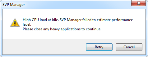

SVP Manager can not measure your GPU performance because of high CPU load.
You must see the message in that case:
http://www.svp-team.com/forum/misc.php?item=3004
Did you?
SVP must be closed if you press Cancel button but it must work further when you press Retry. The message will appear only at first run and you should answer Retry any time you asked (by one time for CPU and by one time for each GPU). Then SVP will measure your performance and copy necessary profile files to settings folder.
BTW, 30% CPU load in idle is not a normal for SVP use. What process loads your CPU so much (see it in task manager, Details tab)?
High_CPU_load_message.png, 7.71 kb, 476 x 184

Thank you for your assistance, my problem has been fixed.
Never realised that ~30% was actually not a normal idle usage figure! Shame on me lol
After investigating, it was PresentationFontCache.exe causing the high usage, and from there on it was easily solved.
