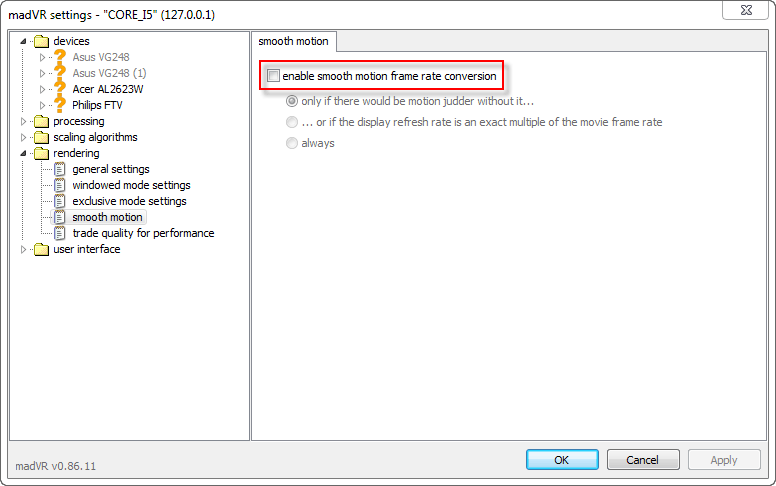

MaXimus
1) madVR - rendering - smooth motion
http://www.svp-team.com/forum/misc.php?item=2979
2) SVP - Active profile settings - Blend frames to screen refresh rate
Both settings must be unchecked.
madVR_smooth_motion.png, 11.56 kb, 776 x 486
