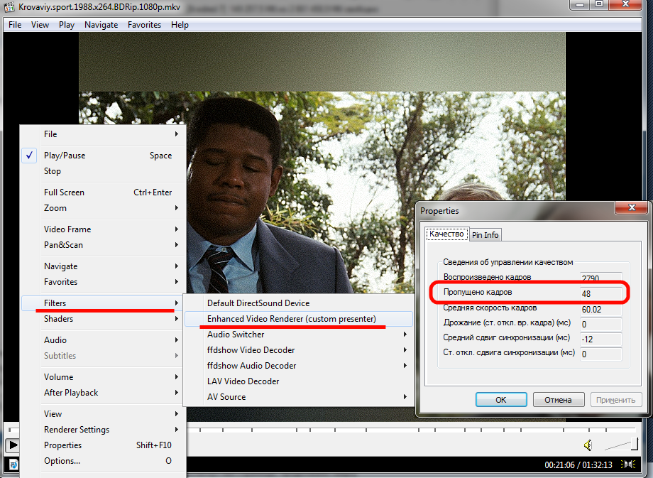

With EVR (cp), I can not control the dropped frames.
http://www.svp-team.com/forum/misc.php?item=2713
пропущено кадров = dropped frames, MPC mix rus/eng interface hmm

Re: Best configuration SVP for my system
With EVR (cp) you can not see any movie because it has deopped frame, the sound skips, SVP and said to lower the profile because there's do it!
With EVR, with all types of movies, there are no dropped frame and Svp works correctly.

Michael
1. check foreground process for GPU load: in GPU-Z - Sensors check GPU Load / Video Engine load in idle, MADVR, EVRCP and EVR.
2. show screen dpclat http://www.svp-team.com/forum/misc.php? … download=1 in idle, MADVR, EVR.
Michael
To do the tests you told me that I have to use video (SD, HD, FHD)?
SD 720*576 or above
HD 1280*720 or above
FHD 1920*1080 or above
Michael
when I use madVR, which settings should I use (Jin or other)?
http://www.svp-team.com/w/images/6/6b/MadVR-decoder.jpg
http://www.svp-team.com/w/images/2/23/MadVR-common.jpg
http://www.svp-team.com/w/images/2/2f/MadVR-upscaling.jpg
http://www.svp-team.com/w/images/5/57/MadVR-downscaling.jpg
Michael
Where is the file override.js to make the change?
in the SVP install folder
If you want to fine tune settings you have to understand what they means!
