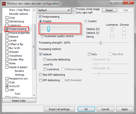

This is good known issue. It is not SVP problem. It is problem of color spaces. You should to turn on postprocessing in ffdShow and to choose second position at the slider. It is a trick to back to YV12 color space from NV12 that causes such color bug.
http://www.svp-team.com/forum/misc.php?item=262
At russian forum this bug is called "blue skin bug" or "avatar's skin bug" wink
Good luck
ffdShow_PostProcessing.png, 49.55 kb, 568 x 479

Fast SPP deblock is more accurate
and process strength = 100% brings some "soap-effect", try it on 50%

So the posterize effect must switch from NV12 to YV too...
But using post-processing don't use some CPU? I'm on the limit of frame drops for some clips  smile I'll do some tests to see which trick is faster  big_smile

I don't remember exactly what I found the best, some time ago and very rare that I have this problem, but I think the best was postprocess with all disabled so no cpu use or minimal  wink but it wasn't using much cpu either way.
