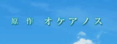

I tried using it because I get weird flickering with on-screen text when the background moves, looks like the frames SVP creates "bend" the text in a way that fits the background. Sadly, I can't provide a screenshot because when I pause the video, it looks normal.

For some reason, mkvextract won't let me split the .mkv correctly, so I can't cut the video. I can provide a screenshot, though:
http://s1.directupload.net/file/d/3225/7g5hkcmp_jpg.htm
The text is in a weird color, I think that's why it gets confused with other objects. Here, the problem arises when the camera pans over the clouds or the sea with fast movements. The image is restored correctly very quickly, but it's still noticeable.
Thanks for your help so far!
You are right.
I see low contrast at text and same colors at text and at background object under text. It can be possible cause of text flickering.
Ok. Can you give me two screenshots of consecutive frames. Then I will found good settings for that frames.
Turn off SVP. Pause while playing. Take screenshot. Ctrl-right arrow (moves to next frame). Take srceenshot again.

Like this? I took more, as I was not sure which would be most useful.
http://s14.directupload.net/file/d/3225 … n3_jpg.htm
http://s7.directupload.net/file/d/3225/5sixvp5w_jpg.htm
http://s14.directupload.net/file/d/3225 … w5_jpg.htm
http://s1.directupload.net/file/d/3225/xor32t86_jpg.htm
http://s14.directupload.net/file/d/3225 … u6_jpg.htm
http://s7.directupload.net/file/d/3225/d68ivk5v_jpg.htm
http://s7.directupload.net/file/d/3225/tecvpcuj_jpg.htm

Good. Thank you for screenshots. Right that I need. 1280x720 - source resolution. Perfect!
Give me one day.

First solution is to use area masking but not standard values. For this you need to point in override.js:
smooth.mask.area            = 300;
smooth.mask.area_sharp      = 2.0;
This change will reduce smoothness at problem areas with flickering artifacts, but text will become much stable. Some ghosts of letters are still present but on full real speed they are not so noticeable.

Makes things a lot better, but only as long as I use default video profiles. With anime settings, the text bends and flickers even more than before o.O
