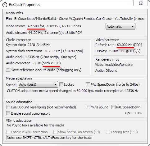

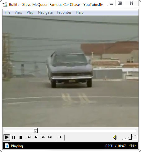

First video smoothed with SVP ideally on my 60 Hz monitor.
Additional info:
Filename: Bullitt - Steve McQueen Famous Car Chase - YouTube.flv
Frame size and frame rate: 438x360 pixels, 25 fps
Detected screen parameters
Screen size and refresh rate: 1920x1080 pixels, 60.024 Hz
Video smoothing info
Smooth factor: 5:2
Resulting video frame rate: 62.5 fps
Drop 2.5 frames every sec (without ReClock)
Selected profile: 720x576@25
http://www.svp-team.com/forum/misc.php?item=2375      http://www.svp-team.com/forum/misc.php?item=2376
Bullitt_MPC-HC.jpg, 34.71 kb, 454 x 490
Bullitt_ReClock.png, 17.51 kb, 483 x 470

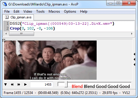

About second video I will write later. Second video have several places with blended frames. I will show it on screenshots.
Re: How to always get wanted target rate like 60 or 75 fps?
Milardo
Second clip created by blend frames in each group of 4 frames into 5 frames to get 29.97 fps from 23.976 fps. It is such kind of telecine. 3:2 pulldown with frame-blending.
Blend pattern: blend-blend-source-source-source
http://www.svp-team.com/forum/misc.php?item=2377
Blended frames have low contrast and slow speed to 0.5x at blend-source and source-blend margins.
Motions in this pattern looks like: slow-normal-slow-normal-normal
Video has periodic jerkiness. Such video can not been smoothed by SVP.
You can try to remove blend from this video. Inform us if you get success.
