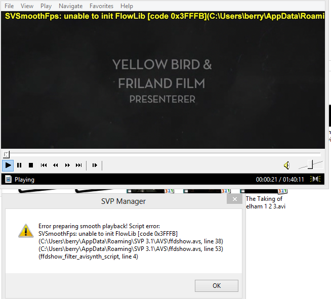

I am getting the following error when trying to run a video with SVP
Please help
I am running on a freshly installed Windows 8 Pro with all windows updates and no Antivirus yet
I installed the latest SVP FULL version 3.1.4
http://img28.imageshack.us/img28/3193/captureyib.png
Capture.PNG, 250.86 kb, 654 x 591

19:49:19.690; Error: Error preparing smooth playback! Script error:
SVSmoothFps: unable to init FlowLib [code 0x3FFFB]
(C:\Users\berry\AppData\Roaming\SVP 3.1\AVS\ffdshow.avs, line 38)
(C:\Users\berry\AppData\Roaming\SVP 3.1\AVS\ffdshow.avs, line 53)
. Duration: 842 ms

Re: Error: unable to init FlowLib [code 0x3FFFB] in Windows 8 Pro x64
berryracer
Thank you for bug report.
This error [0x3FFFB] was on SVP with NVIDIA cards in early versions. It was fixed.
Error tells about video memory leaks.
1. Can you compare used video memory values via GPU-Z on both last SVP versions: 3.1.3 and 3.1.4?
2. What NVIDIA drivers do you use?
3. SVPmark works fine or with errors too?
berryracer
It's an OpenCL initialization error which means (as it defined in specs) - "there is a failure to allocate resources required by the OpenCL implementation on the device".
"Device" is 670M in your case.
Last tme it was SVP's issue but it was fixed like an year ago.
This error happens randomly I guess but happens too often that SVP is unusable when I need it most
Define "randomly".
Is it happens really randomly, or just after some (or many) video file openings / SVP settings changes / seeking in video?
Randomly means 90% of the time, 10% of the time it works...
when I go home, I will try enabling pagefile to a 1 GB min / max as I currently have Pagefile disabled...just to see if it makes any difference...
Also, I was reading on another forum about people having trouble installing codecs on Windows 8 as in they are not working...could that be a reason you think there should be some kind of trick to get codecs working?
Read this if u have time: http://forums.mydigitallife.info/thread … ptop/page2
I am thinking, even though I disabled UAC, Windows still asks me twice before copying, deleting, etc. a file to C:
I read online that there is a registry tweak that totally disables UAC I will also try that when I get home:
http://www.eightforums.com/system-secur … etely.html
berryracer
90% of the time
what action usually you do what leads to the error?
- open video
- seeking video
- nothing (error at the middle of the movie) roll
- another
berryracer
90% of the time
- open video
- seeking video
- another
As soon as the video starts, you know how there is usually a 2 second delay until SVP displays the message on the screen that it is playing the video @ 60 FPS? Well with me, the movie starts fine for 1 second then by the time SVP is preparing for smooth playback it gives me the error with that ffdshow cannot access bla bla bla message
do you want to logon to my computer within 2 hours on TeamViewer to try a few things on my computer?
berryracer
Yeah! It will be great but I don't know how to find the problem. I'm not master of OpenCL smile
Chainik can do more than I can. He has another time zone. He will contact you.
alright.... it is 7:28 am as I am typing, I will be home @ 9 am Dubai Time which is GMT +4
Please bear in mind that I work night shifts so I will be awake for 5 more hours smile
I hope we can work together to resolve this issue SVP is my favorite PC app of all time
I fixed the problem!!!!!!!!!! What I did was:
- Uninstall LAV
- Uninstall madVR
- Uninstall ffdshow
- Install Win 8 Codecs by Sharky (he's a jerk but his codecs are good)
- Tried to run SVP, said ffdshow was not registerd
- Installed ffdshow_rev4499_20130104_clsid
- Ran a movie and SVP works
smile
I hope the error doesn't come back again but if you need any info from my system which will help others please let me know and I will be happy to help
