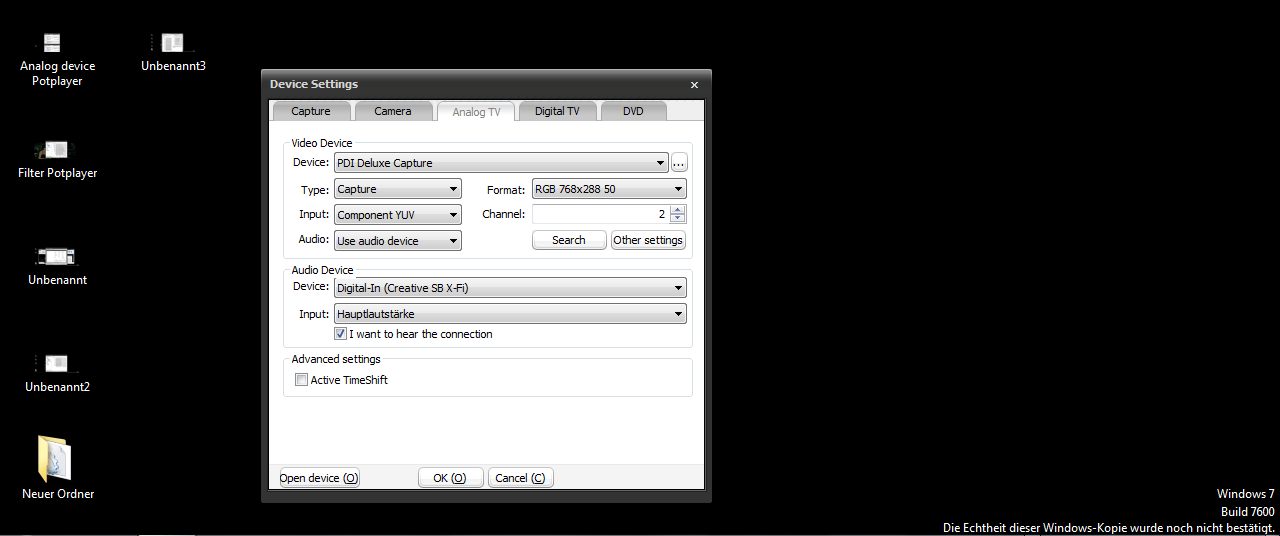

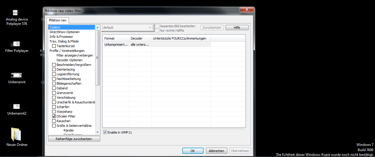

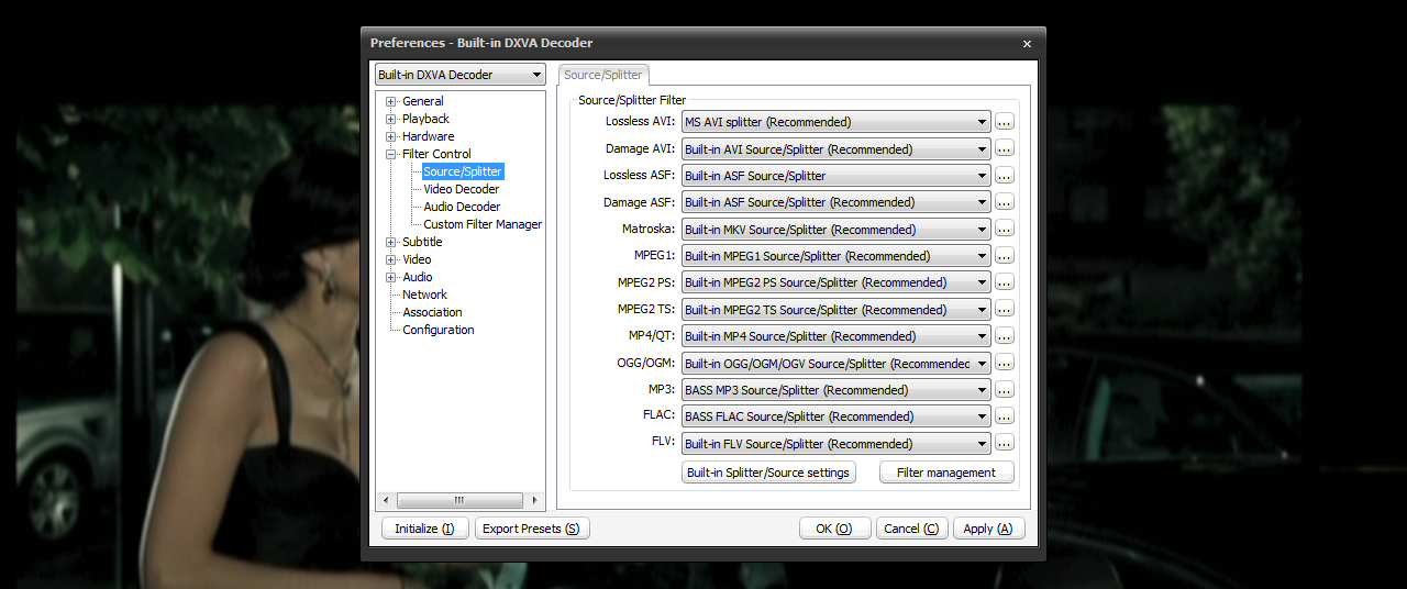

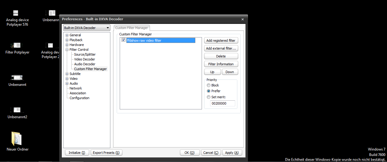

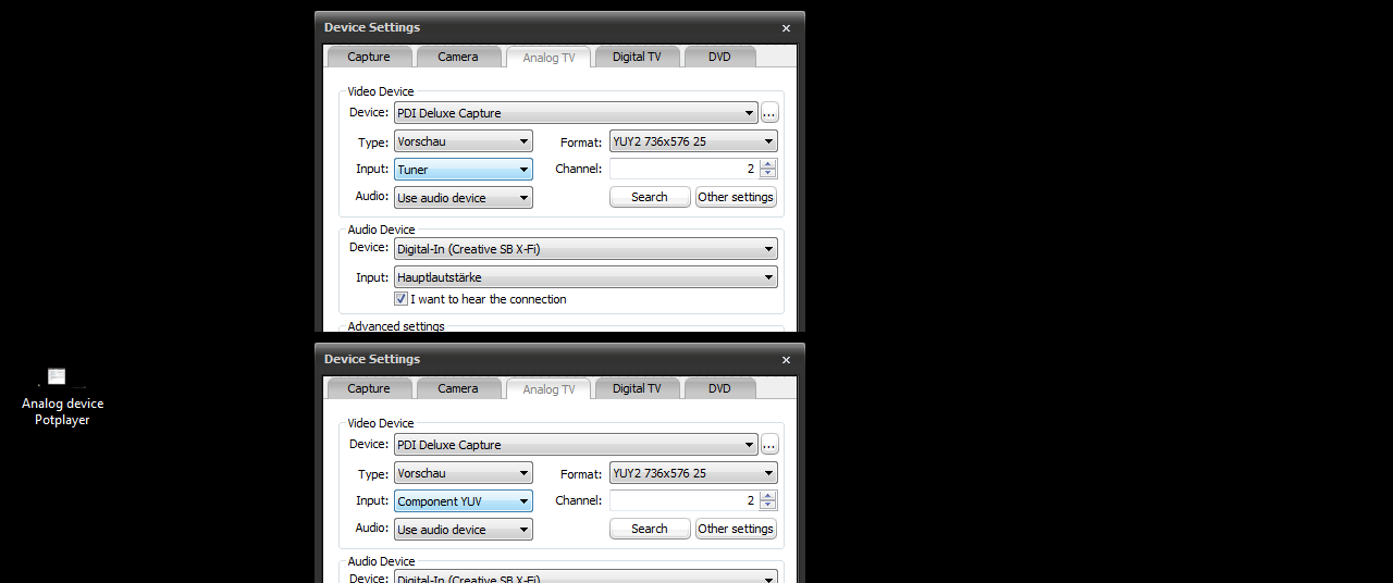

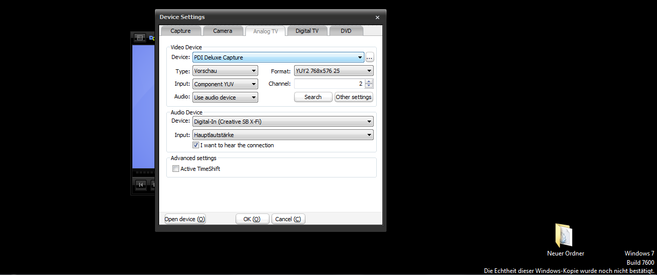

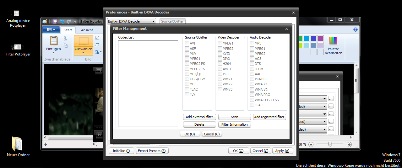

Back to sweetspot and PDI: I have made screen shots, and hope I have everything included. Please let me know if sth is missing. As I said, SVP repots to be working with the green message onscreen, but I was not fast enough to capture that. But no effect :-(

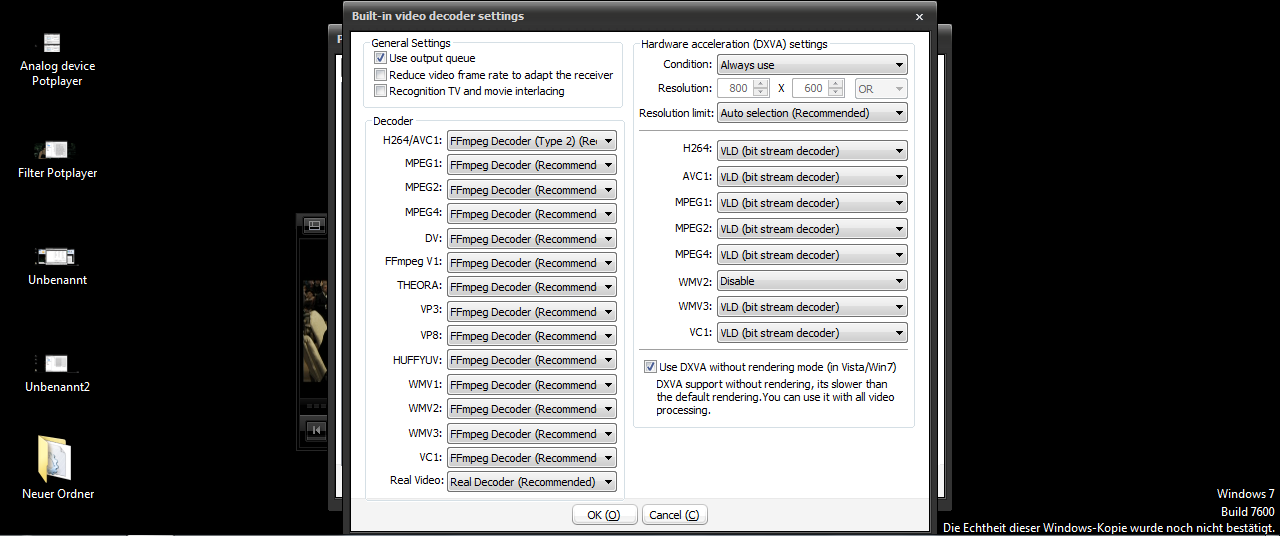

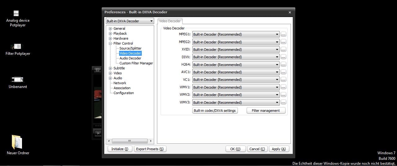

more screen shots:
Re: SVP + Dscaler or oth. software for capture cards (PDI, sweetspot..)
more:

"Information" -> "Last launch log" and "Additional information" from SVP menu would be more helpful wink

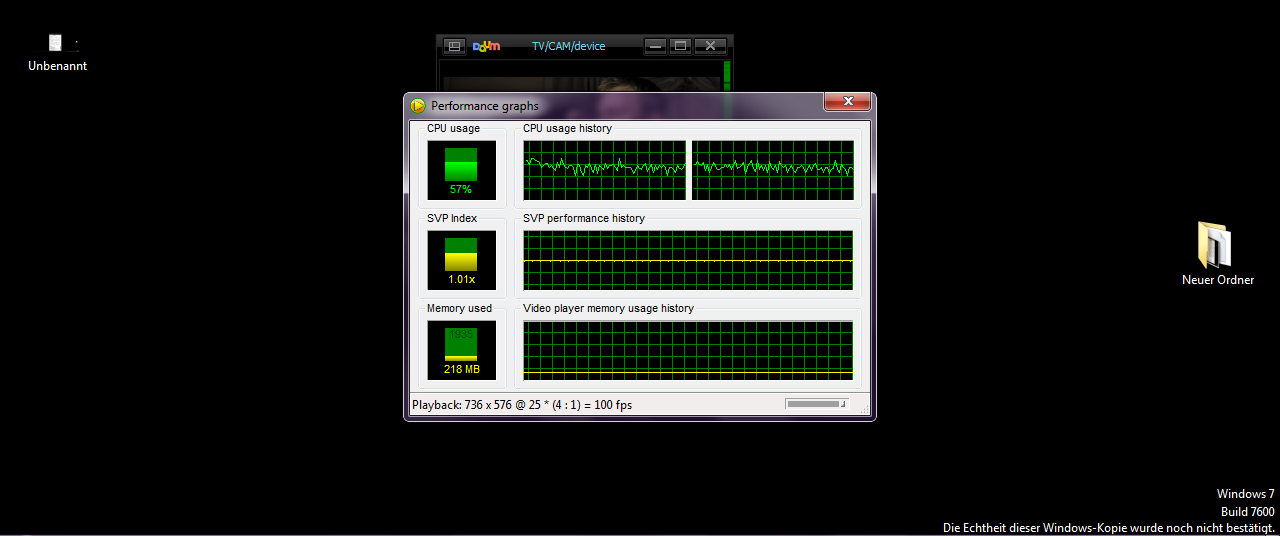

Start your 25hz input, set CRT framerate to 100Hz and run SVP.
Then press Ctrl+F1 in PotPlayer and make a screenshot.
Then open Information - PErformance graphs window in SVP and make another screenshot.

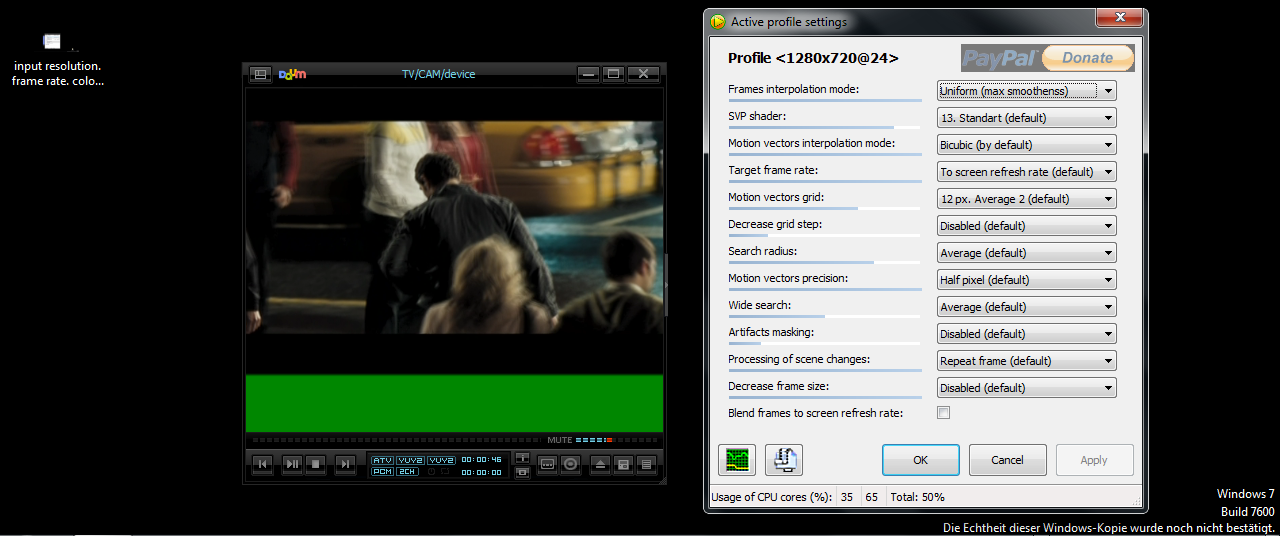

So I just did a more clean run. I hope I included all settings and results.
The DVD film is playing (Bond - Casino Royal), goinig from a DVD Player via YUV into the capture card. Pot palyer is showing the film, SVP is reporing to work - but no motion interpolation.
Thanks for your help!

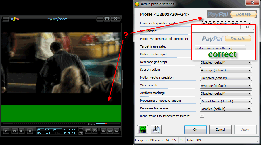

I saw two graphics problems at your screenshot:
1. I have never seen such bad work of alfablending (see dark gray rectangle on PayPal sign). Aflablending works incorrect at your system.
2. What the green bar at the bottom of PotPlayer?
http://www.svp-team.com/forum/misc.php?item=1942
3. What renderer do you using?
It is still lack of info to solve the problem.
4. Please do what Chainik ask you.
Graphics_problems.png, 52.13 kb, 908 x 506

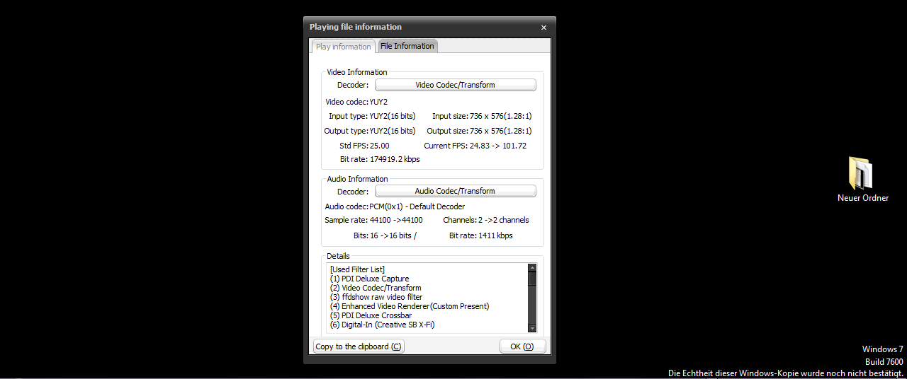

Hello,
I hope that I was able to screenshot the data as Chainik asked for.
No motion interpolation on external input.
I really appreciate your efforts.
Noos
