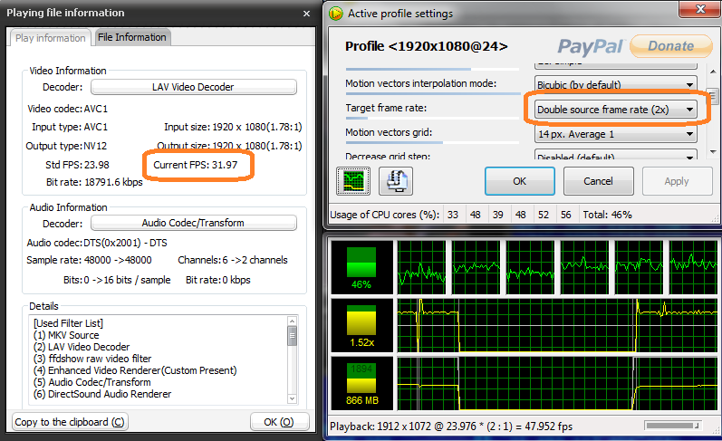

MSmoothFps
SelectEvery(3,0,1)
super=SVSuper(super_params)
smooth_video=SVSmoothFps(super, vectors, smoothfps_params, mt=threads, url="www.svp-team.com")
http://www.svp-team.com/forum/misc.php?item=1755&download=1
24*(2/3)*2 = 32 fps
It works. SVP index goes crazy (48 / 32 = 1.5) but who cares? smile
