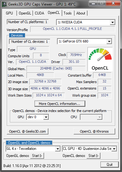

You can help us if you take screenshot of GPU Caps Viewer, OpenCL tab. And copy here infromation from "More OpenCL info" button
http://www.svp-team.com/forum/misc.php?item=1570
- CL_PLATFORM_NAME: NVIDIA CUDA
- CL_PLATFORM_VENDOR: NVIDIA Corporation
- CL_PLATFORM_VERSION: OpenCL 1.1 CUDA 4.1.1

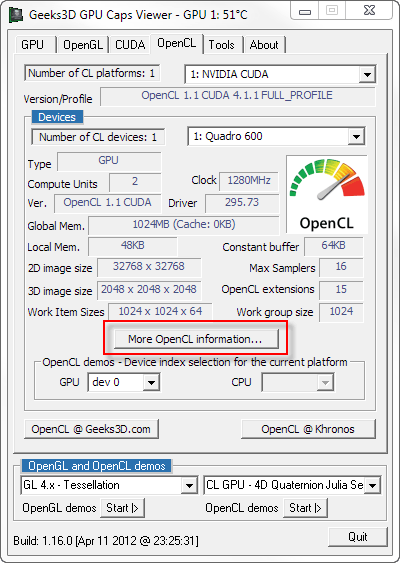

- CL_PLATFORM_PROFILE: FULL_PROFILE
- CL_DEVICE_NAME: Quadro 600
- CL_DEVICE_VENDOR: NVIDIA Corporation
- CL_DRIVER_VERSION: 295.73
- CL_DEVICE_PROFILE: FULL_PROFILE
- CL_DEVICE_VERSION: OpenCL 1.1 CUDA
- CL_DEVICE_TYPE: GPU
- CL_DEVICE_VENDOR_ID: 0x10DE
- CL_DEVICE_MAX_COMPUTE_UNITS: 2
- CL_DEVICE_MAX_CLOCK_FREQUENCY: 1280MHz
- CL_DEVICE_EXTENSIONS:
         - Number: 15
         - cl_nv_d3d9_sharing
         - cl_khr_d3d10_sharing
         - cl_nv_d3d11_sharing
         - cl_nv_compiler_options
         - cl_nv_device_attribute_query
         - cl_nv_pragma_unroll
         - cl_khr_global_int32_base_atomics
         - cl_khr_global_int32_extended_atomics
         - cl_khr_local_int32_base_atomics
         - cl_khr_local_int32_extended_atomics
         - cl_khr_fp64
- CL_NV_DEVICE_COMPUTE_CAPABILITY_MINOR: 1
- CL_NV_DEVICE_REGISTERS_PER_BLOCK: 32768
- CL_NV_DEVICE_WARP_SIZE: 32
- CL_NV_DEVICE_GPU_OVERLAP: 1
- CL_NV_DEVICE_KERNEL_EXEC_TIMEOUT: 1
- CL_NV_DEVICE_INTEGRATED_MEMORY: 0
- CL_DEVICE_ADDRESS_BITS: 32
- CL_DEVICE_MAX_MEM_ALLOC_SIZE: 262144KB
- CL_DEVICE_GLOBAL_MEM_SIZE: 1024MB
- CL_DEVICE_MAX_PARAMETER_SIZE: 4352
- CL_DEVICE_GLOBAL_MEM_CACHELINE_SIZE: 128 Bytes
- CL_DEVICE_GLOBAL_MEM_CACHE_SIZE: 32 KB
- CL_DEVICE_ERROR_CORRECTION_SUPPORT: NO
- CL_DEVICE_LOCAL_MEM_TYPE: Local (scratchpad)
- CL_DEVICE_MAX_CONSTANT_BUFFER_SIZE: 64KB
- CL_DEVICE_MAX_WORK_ITEM_DIMENSIONS: 3
- CL_DEVICE_MAX_WORK_ITEM_SIZES: [1024 ; 1024 ; 64]
- CL_DEVICE_MAX_WORK_GROUP_SIZE: 1024
- Execute native functions: NO
- CL_DEVICE_QUEUE_PROPERTIES:
         - CL_QUEUE_OUT_OF_ORDER_EXEC_MODE_ENABLE
         - CL_QUEUE_PROFILING_ENABLE
- CL_DEVICE_IMAGE_SUPPORT: YES
- CL_DEVICE_MAX_READ_IMAGE_ARGS: 128
- CL_DEVICE_MAX_WRITE_IMAGE_ARGS: 8
- CL_DEVICE_IMAGE2D_MAX_WIDTH: 32768
- CL_DEVICE_IMAGE2D_MAX_HEIGHT: 32768
- CL_DEVICE_IMAGE3D_MAX_WIDTH: 2048
- CL_DEVICE_IMAGE3D_MAX_HEIGHT: 2048
- CL_DEVICE_IMAGE3D_MAX_DEPTH: 2048
- CL_DEVICE_MAX_SAMPLERS: 16
- CL_DEVICE_PREFERRED_VECTOR_WIDTH_CHAR: 1
- CL_DEVICE_PREFERRED_VECTOR_WIDTH_SHORT: 1
- CL_DEVICE_PREFERRED_VECTOR_WIDTH_INT: 1
- CL_DEVICE_PREFERRED_VECTOR_WIDTH_LONG: 1
- CL_DEVICE_PREFERRED_VECTOR_WIDTH_FLOAT: 1
- CL_DEVICE_PREFERRED_VECTOR_WIDTH_DOUBLE: 1
GPU_Caps_Viewer.png, 16.63 kb, 400 x 563

===================================[ OpenCL Capabilities ]
- Num OpenCL platforms: 1
- Num devices: 1
    - CL_DEVICE_NAME: GeForce GTX 680
    - CL_DRIVER_VERSION: 301.10
    - CL_DEVICE_MAX_COMPUTE_UNITS: 8
    - CL_DEVICE_MAX_CLOCK_FREQUENCY: 705MHz
    - CL_NV_DEVICE_COMPUTE_CAPABILITY_MAJOR: 3
    - CL_NV_DEVICE_COMPUTE_CAPABILITY_MINOR: 0
    - CL_NV_DEVICE_REGISTERS_PER_BLOCK: 65536
    - CL_DEVICE_MAX_MEM_ALLOC_SIZE: 524288KB
    - CL_DEVICE_GLOBAL_MEM_SIZE: 2048MB
    - CL_DEVICE_GLOBAL_MEM_CACHE_SIZE: 128KB
    - CL_DEVICE_LOCAL_MEM_SIZE: 48KB
    - CL_EXEC_NATIVE_KERNEL: 3995188
    - CL_DEVICE_MAX_READ_IMAGE_ARGS: 256
    - CL_DEVICE_MAX_WRITE_IMAGE_ARGS: 16
    - CL_DEVICE_IMAGE3D_MAX_WIDTH: 4096
    - CL_DEVICE_IMAGE3D_MAX_HEIGHT: 4096
    - CL_DEVICE_IMAGE3D_MAX_DEPTH: 4096
    - CL_DEVICE_MAX_SAMPLERS: 32
    - CL_DEVICE_EXTENSIONS: 15
    - Extensions:
        - cl_khr_byte_addressable_store
        - cl_khr_icd
        - cl_khr_gl_sharing
        - cl_nv_d3d10_sharing
        - cl_khr_fp64
GTX680_OpenCL.png, 41.37 kb, 396 x 559

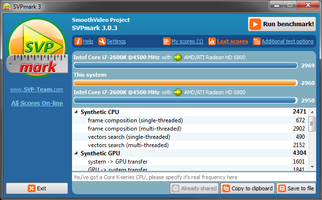

14 (edited by flagger 03-05-2012 09:40:38)
Re: [FIXED] GTX680 and acceleration
Edit: Doh just noticed it's the comparison systems.... lol
Just noticed in the results screen in SVPMark it detects the wrong GPU:
http://www.svp-team.com/forum/misc.php?item=1574
WrongGPU.png, 69.37 kb, 662 x 412
flagger
Thanks!
flagger
Orange result is your. Blue results - are other system's results to compare with your. wink
See "My scores" tab to know how your GPU detected and named.
Fixed in SVP pre-3.1.2 patch, SVPflow 1.0.5 and SVPmark 3.0.3a
