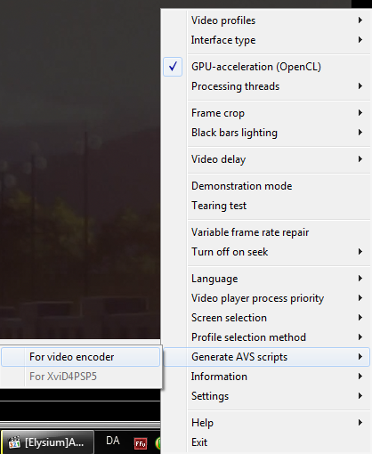

It can also be done by simply creating an AVS-script from SVP-manager. While the video you want to interpolate frames for is playing, click this option in SVP and save the script. The script can then be opened by popular video editors, for example virtualdub. However, virtualdub only outputs as .AVI, so if you're new into this stuff, just follow Chainik's tutorial.
http://www.svp-team.com/forum/misc.php?item=1529
svpsave.png, 102.44 kb, 418 x 510

I believe the one Chanik linked is what SVP was originally based on. If you want the best quality, use the method I mentioned. You can just crank your settings to the max. Since it doesn't have to interpolate in realtime, you can turn on "complicated" shader and stuff like "decrease grid step" aswell. However, you will have to recompress the video yourself with virtualdub or x264 afterwards, since virtualdub will simply output uncompressed video.
