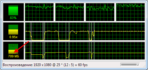

I check by EVR Custom Statistic by Ctrl-J. The grapic must be parallel to other lines. See picture from this post.

Yes. I have Quadro 600 on my work computer with i5-2300 processor. And I can play video smoothly only with software decoding if this video is FullHD. It is hard to this videocard to do hardware FullHD-decoding and SVP's GPU-acceleration together.
travolter
Fast measurements results:
LAV DXVA2 + MPC-HC = 865 MB
LAV CUVID + MPC-HC = 836 MB
LAV None + MPC-HC = 778 MB
ffdShow + MPC-HC = 771 MB
CoreAVC CUDA + MPC-HC = 734 MB
CoreAVC None + MPC-HC = 726 MB
CoreAVC None, Low latency + MPC-HC = 709 MB
http://www.svp-team.com/forum/misc.php?item=1123
Total savings: 865 - 709 = 155 MB smile
Core i5-2300, Quadro 600, HD-Clip: hd_other_philips_the_hong_kong_connection.mkv, EVR Custom renderer, ReClock, SVP default profile 1920x1080@24.
You can do it for another decoders and players.
