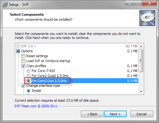

1. First of all you should check item "Core2Duo profiles" when install SVP (pic).

SVP_C2D_profiles.png, 36.92 kb, 513 x 398

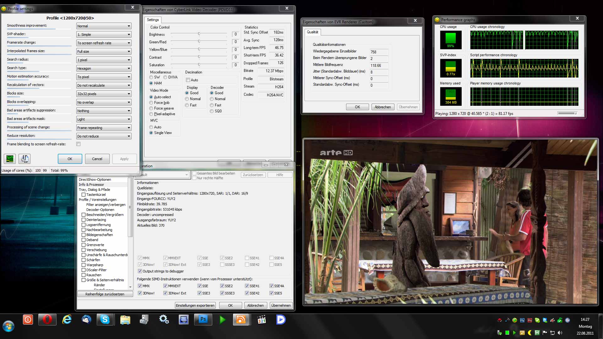

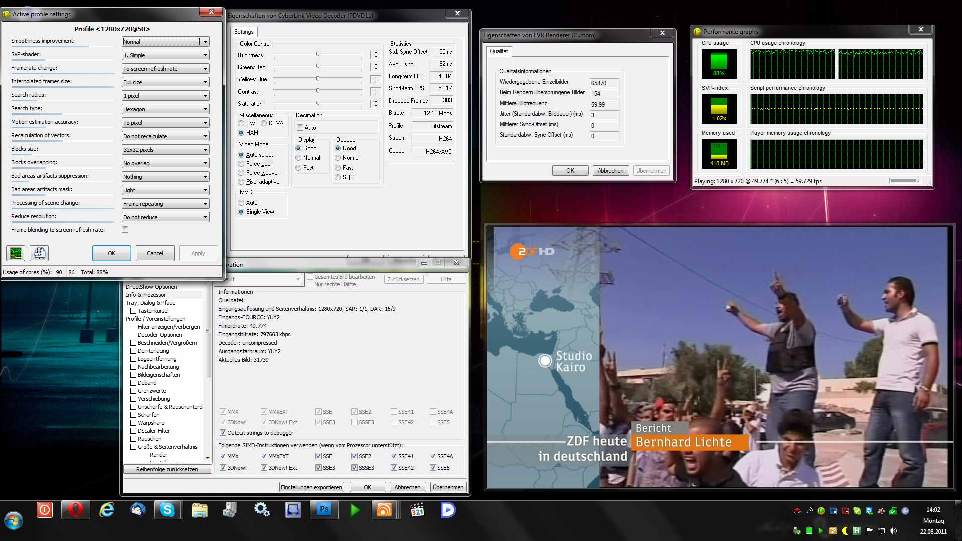

but you system can smooth video up to 720p at simple settings, even Atom-based system can smooth video, MAG79 confirm, watch test result in forum svp-mark, first message
I am interesting svp-index score, please, press CTRL+SHIFT+G while playing video and show screenshot with GPU-ON and GPU-OFF

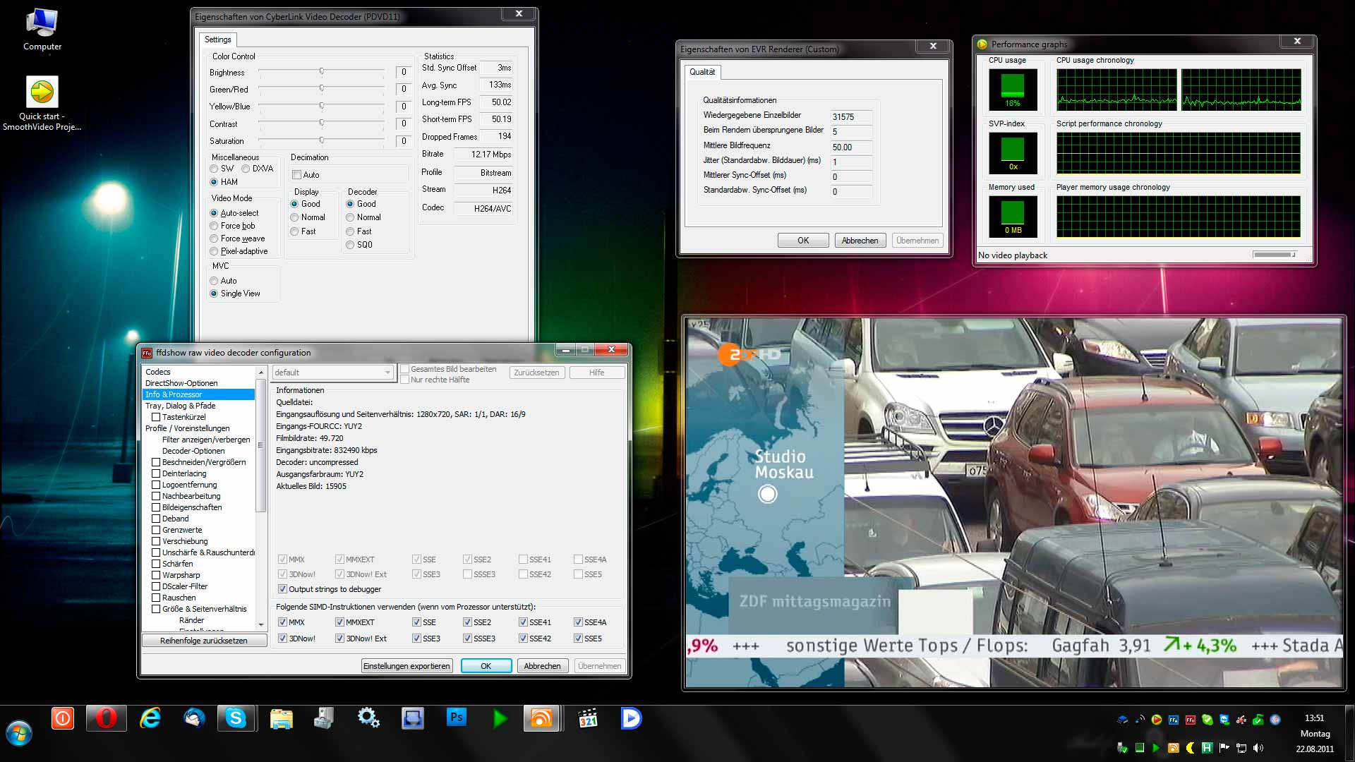

OK, I played around with 720p50 material from our german tv stations. without_svp.jpg shows a screenshot with SVP stopped. All frame rates (in decoder, in ffdshow and in the evr) are around 50fps (as they should be). gpu.jpg shows a screenshot with SVP (gpu mode) turned on. The decoder and ffdshow input frame rate is 50fps. The evr shows 60fps. So everything is fine here except for the video stuttering due to my slow machine. Now it becomes a bit more interesting. The screenshot cpu.jpg, which shows SVP without gpu-acceleration, proofes that the gpu-acceleration is generally working. Because without it you can see that even the decoder isn´t able to keep the frame rate at 50 fps. But could you please tell me why the frame rate of the evr goes wild? It oscillates between 40 and 120. The screenshot shows for example 118.66 fps. Shouldn´t it be limited to 60 which is the monitor refresh rate when SVP is configured with "To screen refresh rate"? This strange behaviour results by the way in a number of message boxes popping up (see msgbox.jpg).
Well, here is another, more general question. When I think about the small hd resolution which is broadcasted with 50 frames per seconds, which is fine for video stuff, I wonder how films are handled, whose frames (speeded up from 24 to 25) were duplicated to 50fps. Does SVP first restore the original 24 frames (somewhere on your website I saw ReClock) and then secondly smooth these 24 frames to whatever is configured? Or how does SVP handle this case?
Thanks a lot for your good work, the infos and your patience,  wink
Wolpers

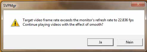

About messagebox about wrong (big) framerate. It is left video or not correct DS-Splitter. Change it to another.
