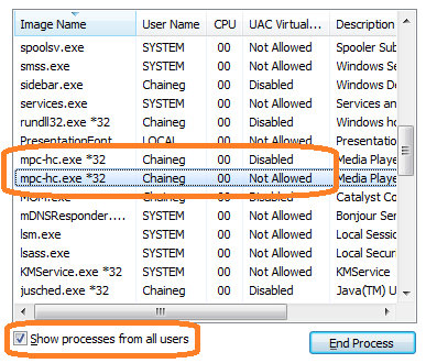

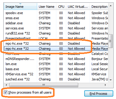

Re: Waiting for ffdshow video... issue
See the picture:
http://www.svp-team.com/forum/misc.php?item=722&download=1
First instance of mpc-hc is "disabled" and it means it's running with user privileges, second one is "not allowed"
(I've to check "show processes from all users" first for "not allowed" value to show)
and it's running as admin.
So you just have to figure out why your MPC-HC runs as admin. May be you've got "Run this program as administrator" option checked at "Properties" -> "Compatibility" page and some strange (="non default") UAC settings?  hmm
uac.png, 21.38 kb, 387 x 330
35 (edited by dsgnethu 14-11-2011 22:19:54)
See the picture:
Chainik! Since I just did a default installation of SVP, I did not modify or alter MPC-HC installation settings in any way. I did not set anyting on it's properties. It's the same for UAC, it's not disabled, nor any settings modified.
Yes, You're right, maybe for some reason, MPC-HC runs as admin. So? Does it modify anything in a way, that SVP is not working except I start it as admin? So... "normally", does SVP and MPC-HC has to run together as non-admin?
Properties for MPC-HC (in SVP default installation):
http://dsgnet.hu/mpc-hc.jpg
Non-privileged process (SVP) can't "talk" with privileged one (ffdshow instance inside MPC-HC). That's the reason.
Yes, sure.
So it's a miracle. I wash my hands big_smile

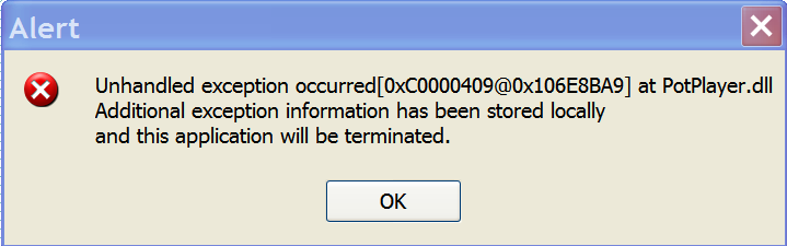

38 (edited by nolan_vede 15-03-2013 20:13:42)
Installed SVP_3.1.4.exe full (did not install mpc or madvr)
Followed instructions at http://www.svp-team.com/wiki/Daum_PotPlayer_with_DXVA
In my current Potplayer version, there is no "prefer" option, but everything else was set
Fixed in Preferences -> General -> Multiple launching: Play the clicked file (it was set "add the file to playlist")
Waiting for ffdshow video on systray icon mouseover.
Unhandled exception occurred at....... potplayer.dll
http://www.svp-team.com/forum/misc.php?item=2405
That's about it, I don't what else to offer at this time.
Please advise
thanks
__________________________________________
SVP_3.1.4.exe
PotPlayer 1.5.36073
XP PRO SP3
IE 8
FIREFOX 19 & 20B4
nVIDIA GeForce GT 610 (GF119)
GeForce 310.70 - WHQL Driver - Dec 17, 2012DualCore
Intel Pentium D 805, 2666 MHz (20 x 133)
2 gb ram
1.png, 15.01 kb, 719 x 225
PotPlayer_exception.png, 7.29 kb, 718 x 225

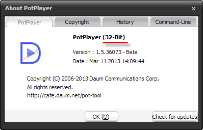

nolan_vede
I just special for you download and install PotPlayer 1.5.36073 Beta.
And I can select Prefer. Did you read instruction right?
select it and choose "Prefer" then press "Filter Information" button
http://www.svp-team.com/w/images/e/ec/Pot-dxva-6-en.jpg
SVP works fine with PotPlayer after all instruction steps are done.
What PotPlayer version did you install?
It must be 32bit version.
http://www.svp-team.com/forum/misc.php?item=2406
PotPlayer_32bit.png, 7.6 kb, 398 x 255

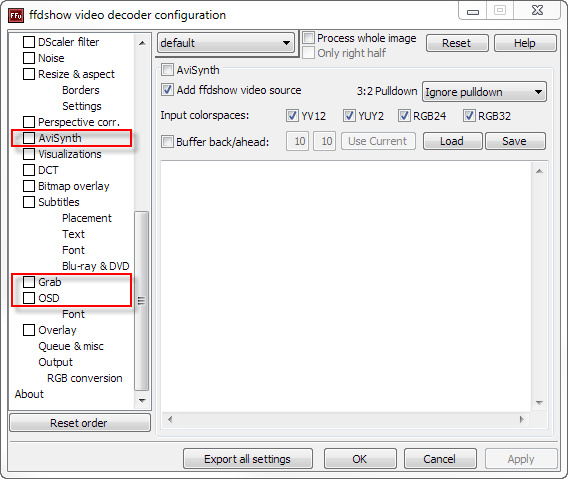

dupcengier28
Check please is all these tabs are present in your ffdShow?
http://www.svp-team.com/forum/misc.php?item=2421
If not then enable them from "Show / hide filters" tab.
ffdShow_tabs_necessary4SVP.png, 16.22 kb, 568 x 479

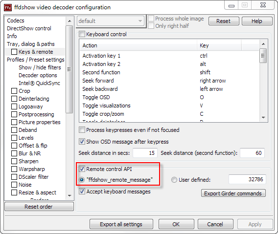

dupcengier28
1. Check the Remote control API is enabled.
2. Please relaunch SVP Manager and put here last launch log: SVP tray menu - Information - Last launch log.
http://www.svp-team.com/forum/misc.php?item=2422
ffdShow_RemoteControl.png, 19.74 kb, 568 x 479

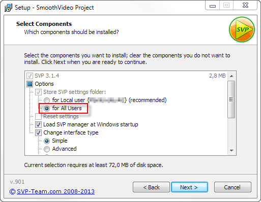

dupcengier28
I see all is correct in the log except one thing. User name is not ANSI. It has unicode letter at end: Paweł
Maybe this is the cause of ffdShow waiting error.
Can you add new English-named user to the system and try again?
Or another way: you can reinstall SVP with pointing settings folder to All Users.
http://www.svp-team.com/forum/misc.php?item=2424
Please check it.
SVP_for_AllUsers.png, 14.17 kb, 513 x 398
