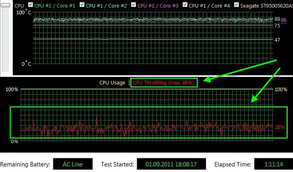

I ask about CPU Throttling. You did not say anything about it. Ok. See at the picture.
http://www.svp-team.com/forum/misc.php?item=708
Did you pass this test and what about CPU Throttling value?
Normally it should be 0.
AIDA64_CPU_Throttling.jpg, 53.13 kb, 600 x 354

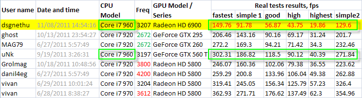

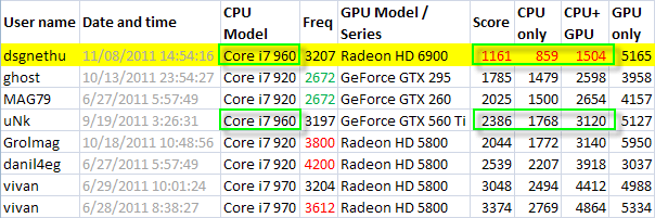

About SVPmark. Your results are very low. sad
Exactly half of the normal values: 859 vs 1768 (uNk).
Why number of threads is only 4? It should be 8.
HyperThreading enabled?
Just look at the tables.
http://www.svp-team.com/forum/misc.php?item=711
http://www.svp-team.com/forum/misc.php?item=712
Tables shows all results with Core i7 9xx CPU at "FHD" resolution (GPU is on). Sorted by "CPU only" score.
dsgnethu_SVPmarks1.png, 12.75 kb, 604 x 201
dsgnethu_SVPmarks2.png, 15.25 kb, 743 x 201
Re: Problem with SVP 3.0.5
Lets analyze results we have got.
1. CPU Throttling is absent - good
2. SVPmark results is low - bad
3. dpclat in green zone - good
4. CPU load in idle is 0 - good
So, we need detailed information about SVPmark results ("Run" at default settings, "Save to file" and put it here) and about your hardware (for example show AIDA64 HTML report).
