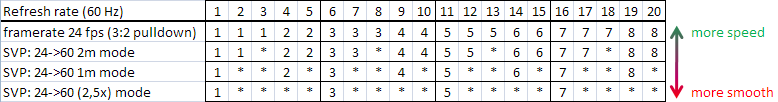

Frame Rate Change: what's the difference in each setting?
See the picture. Difference in smoothness and in speed in CPU mode.
http://www.svp-team.com/forum/misc.php?item=698
2m - each source frame shows twice.
1m - each source frame shows once.
2.5x - not each source frame shows.

Framerate_change.png, 11.39 kb, 778 x 102

Deference in speed and in smoothness
... in speed in CPU mode wink
