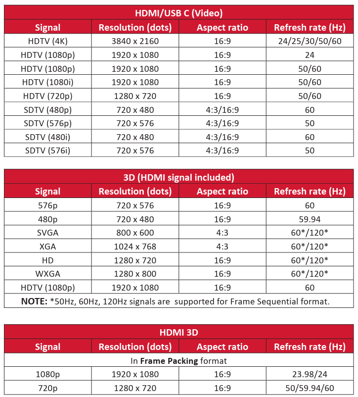

My projector does support frame packing input (see at the bottom of projector's spec sheet), hence I get 3d framepacking to automatically start and work perfectly as soon as i play a bd3d.iso via MPC-BE with Madvr (only seems to work with MadVR as video renderer). Automatically plays 3d framepacking at 1080p@24hz and looks great... but I wished it was smoother, ie. wished i was able to incorporate some for of interpolation/smoothness. I just can't get SVP 4 pro to work at the same time, even though people report that it's supposed to be able to work with MPC-BE ... and supposedly 3d framepacking.

"i get the 2 images, upper and lower" -- this is "frame packing"
but the frame packing is at 60 fps, while your table list only 1080p at 24 fps
what if SVP is active, but turn off frame rate conversion in a video profile?
Re: PLEASE HELP: SVP4pro not working bd3d.iso (framepacking) + MPC-BE1.8.8
3D frame packed: 720p 60/50, 1080p 24
3D sequential: all the above including 1080p@60fps
